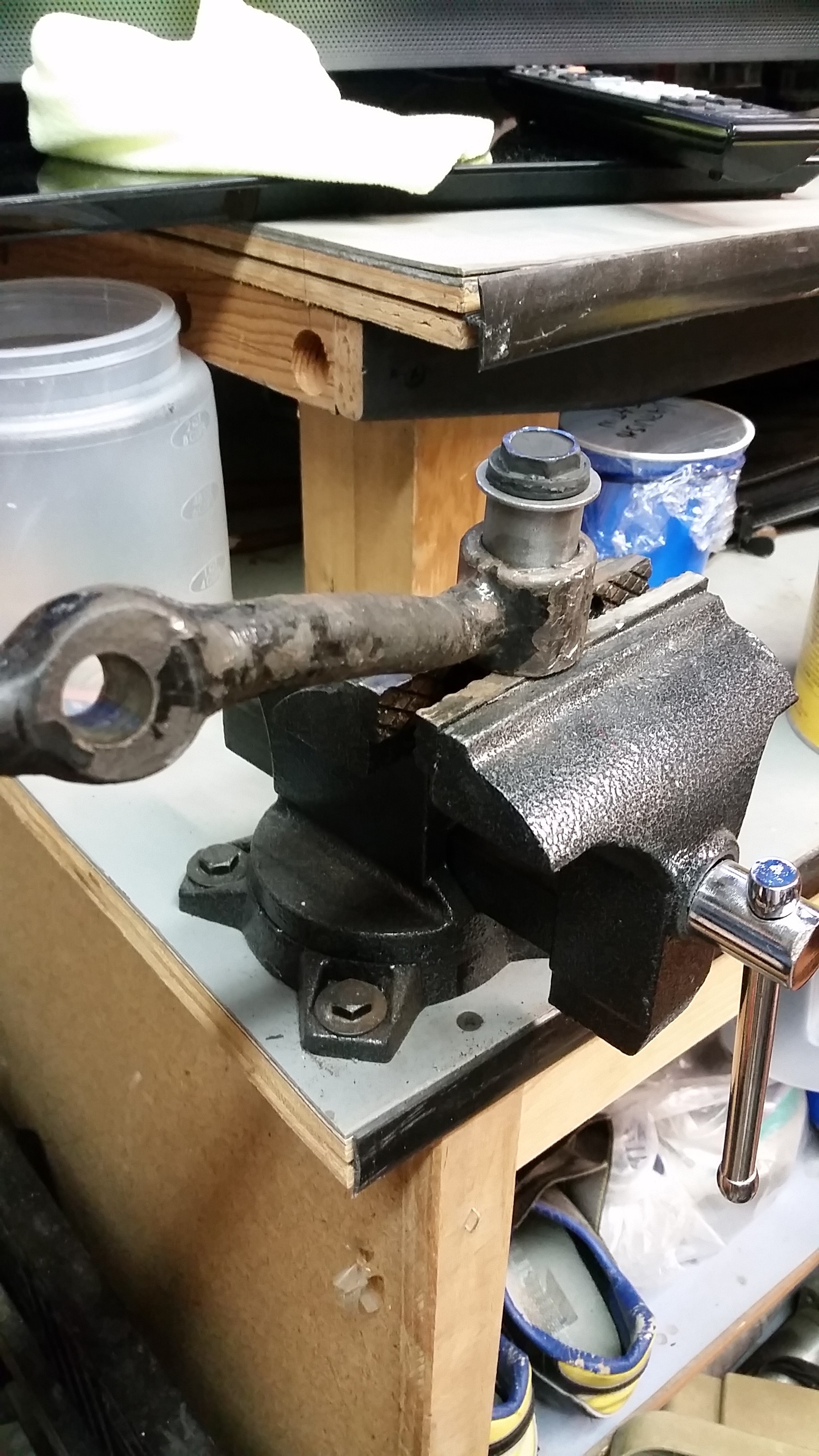

Hi, Finally removed the old Pitman Bushing from the Drag Link. Had to remove the Drag Link so I could put it in a vice. Now I have purchased a new Pitman Bushing from Clarks. The rubber assembly with the new shell attached. Trying to put the new one into the Drag Link, it is a press fit. Is that correct? Once I pound it in, it will never move. Just want to make sure that is OK before installing.
New Pitman Bushing ready to be pounded in.
Extracting old Pitman, and blood along the way.
MyRed63
Posts: 2182
Re: Pitman Arm Bushing TOO TIGHT!
Too late now but the trick to get the old metal sleeve out is to use a hacksaw to very carefully cut through the wall of the sleeve from the inside. The kerf of the saw cut relieves the tension in the sleeve and you can pull it out easily. Yes, you will have to remove the blade from the hacksaw handle and re-install it while the blade is captured by the hole.
Press in the new sleeve and bushing. You're ready to go. When it's back in the car, make sure the steering is centered, wheels pointed straght ahead before you tighten it down.

BTW you are really supposed to hammer on the tools not your fingers:) I can not count how many times my hands have looked like that!! I prefer to press rather than hammer in things like this. More control of what is going on and less chance of damage. That vice you have might go wide enough to press that if you have a short socket or pipe piece to fit over the rubber of the new bushing.

Oh, Hack saw would have been a good one. Thanks. The vice does go that wide so I think I will try that with a socket around the bolt end to press the new one in. As you can see in this picture, I had a bit of play in the steering. ::-):
Original Pitman.  Where is the rubber?
