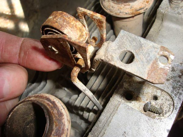

It sounds like you were describing a partial opening of the choke mechanism. Both sides should open at approximately the same rate. They are each controlled by a bi-metallic coil that responds to engine heat. If each bank of cylinders is receiving approximately the same fuel/air mixture from each carburetor and all cylinders are being treated equally by the ignition system. temperature rise and operating heat should be comparable on both cylinder banks. If one side is slow to open the choke mechanism, it could be an indication of one side receiving less fuel mixture, an ignition problem, or poor compression in one or more cylinders indicating that the one cylinder bank is running colder and perhaps producing less power for some reason. Alternately, a faulty or incorrectly adjusted choke mechanism might be indicated.
The images below depict the automatic choke mechanism found on normally aspirated 1962-1969 Corvairs. The attached publication, DELCO ROCHESTER - Models H, HV Carburetor Service Manual, contains a comprehensive description of the operation of each carburetor subsystem. Reading it my clarify for you how the carburetors function in response to engine operating changes. Understanding what "normal" looks like and why the carburetors function the way they do can help you in detecting, interpreting and correcting abnormal or faulty operation.

The choke vacuum break mechanisms only have an effect when the engine is cold and the chokes are applied. They have an effect of opening the choke butterfly mechanism somewhat as you drive the car with the engine still cold and not quite up to normal operating temperatures. This lets in more needed air with the engine operating at higher rpm speeds. Once the engine has warmed up the chokes are fully disengaged by the automatic choke mechanism and the vacuum break mechanisms no longer have any effect. HOWEVER, IF THERE ARE ANY VACUUM LEAKS INSIDE THE PLASTIC CASES, THOSE VACUUM LEAKS COULD STILL IMPACT THE ENGINE OPERATION BY LETTING ADDITIONAL AIR INTO THE INTAKE MANIFOLD AS IT LEAKS PAST THE INTERNAL RUBBER DIAPHRAGM. To check this, the rubber hoses could be temporarily disconnected from the vacuum break units and plugged. This would have no impact on an engine that has warmed up and is not using the chokes, but it would also eliminate any possibility of vacuum leaks through these diaphragms. Then the car can be driven to test to see if the operating performance has changed.

The functional operation of the choke mechanism is described on page 8 of the attached manual: DELCO ROCHESTER - Models H, HV Carburetor Service Manual (shown below). Once the engine has been warmed up to normal operating temperature, the vacuum breaks no longer impact the carburetor choke operation (since the choke valves have been fully opened by the choke coils). If you suspect engine performance has been degraded by a vacuum leak — possibly from an internal vacuum leak in one of the vacuum break diaphragms —each hose can be temporarily disconnected from the vacuum break and an appropriately sized screw can be inserted in each hose to plug the carburetor vacuum connection. A test drive can then be performed to determine if engine operation has been improved.
