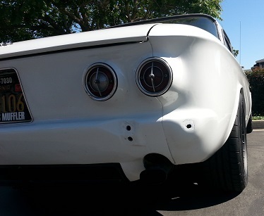

I wish I knew the specs of the wheels on this Corvair as it has pretty much exactly the look I want

Here is the build thread for that car. viewtopic.php?f=52&t=5040#p33758
I sent him a message and asked what the specs are. I am also wanting to put a similar look on my 63.

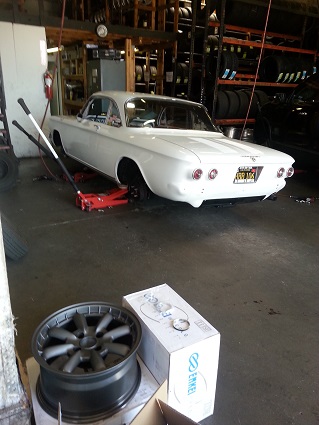

Getting closer, just have to make a decision on final tire size. Now that their here I got to say their HUGE 16x7 front and 16x8 rear. I hope I didn't go too big and get this wrong. I will roll my fenders/phone book pull them tonight on the stock rims and tires I have now. I'm hoping to create some clearance now and it will be enough. If not then I'll do more with the new rims and final tire size when mounted. I'm leaning towards 205-50-16 up front, and 215-50-16 in the rear.

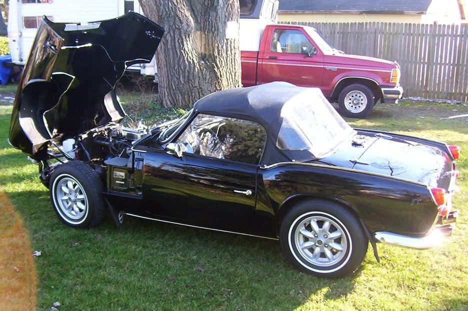

Hope the fit, they will look good. Close to what I had on my Spitfire, but I only had 175 -80 -13's.

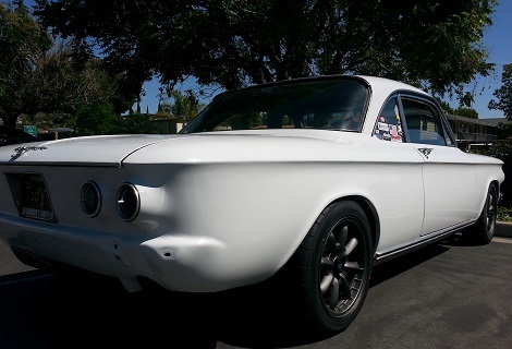

Ok they are now on the car and it looks and drives pretty good I'd say. Final tire size was as stated in the above post, 205-50-16 FT, and 215-50-16 RR
The fitment I would have to say is almost perfect and if I had to make a change it would be to go with a 45 series tire in front and not 50. While driving by myself I had no rubbing issues at all and this included having the stock rims/tires in the car behind me on the way back to work. My Dad needed a ride to pick up his car at another shop and then I started to get some rubbing on the passenger side in front. Once I got home I pulled the front wheels off and busted out the heat gun and a "BFH" and pounded the inner lip into submission on both sides. This seemed to help the clearance. The rears fit perfect with no issues at all, keep in mind though I did phone book pull the rear fenders out earlier this week on the stock tires so I had made a little room for the new tires already.
The taller tire in the rear has taken the edge off the 3.89 axel ratio and the car keeps up with traffic on the freeway about 300 rpm less. With my quick boost response city driving is fine too. here are a few pic's lighting in some isn't great but you'll get the idea.
