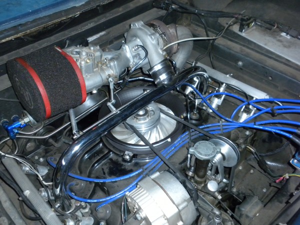

Here's mine... port injected early turbo. The engine temp sensor is at the end of the #1 head and is more or less measuring the port temperature, which is giving the best indication of fuel evaporation. I've found that it is best to use the "stock" engine temp sensor values that come with the SDS efi, (the system I use). Since this system was developed around usage in air cooled experimental aircraft, I shouldn't have been too surprised that the stock values that come with the unit work the best. The throttle body is a gutted Weber 45dcoe, and because of the extensive modifications to it, flows approximately 750 cfm. I try to keep the peak boost at 20psi or below!!

Re: Fast EFI Corvair?
I see you got one of them there fancy fans!
Yes... This is the very first prototype, only 1 of 2. Soon there will be a small bunch being shipped to customer's, and I wont be the only one that knows what its like to have a fan like this...I'm sure it will turn out to be as important a modification as EFI is. The combination of the EFI and the super efficient fan has to be experienced to be believed!!
