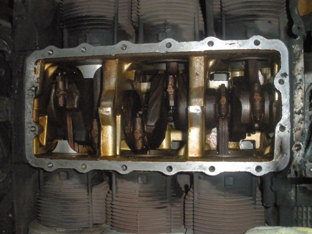

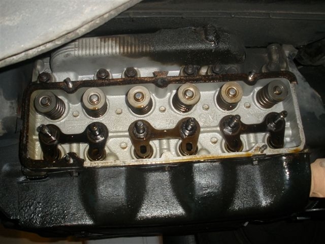

Use the best oil you can find or wish. I have used AmsOil in the past. It's darn good oil.. However:
This is an example of one of my engines after 128,000 miles. I rebuild and go through this engine at about that interval, just because of mileage and seal wear. It's my daily driver Greenbrier.
The oil I have been using for 35+ years is straight weight 30, non synthetic. You call it mineral oil, we call it Dino oil.
The secret is to change it at 2400 - 2500 mile intervals. Air cooled engines burn oil due to running temperatures. Changing more often reduces the black burn.
This engine is not a performance engine. Not a turbo. It's also is not exposed to heavy engine loads. But pictures tell quite a story.
Also, the crankshaft has over 300,000 miles that I personally put on it. It's standard - standard. Never been turned and within factory wear tolerances. Another reason to change your oil often.
As I said, use the best oil you want to. This works for me.
