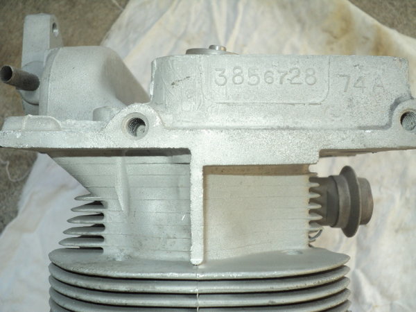

* Since the engine case serial number suffix letters are specifically for a 140 hp, four carburetor engine originally installed in a 1965-66 Corsa, you can conclude that the actual engine production date was either 03/08/65 or 03/08/66.
The presence of a solid cast crankshaft pulley on this engine likely means that the original harmonic balancer had failed, and that a solid cast pulley was substituted as a cost saving measure, since replacement harmonic balancers are not inexpensive. GM engineers specified the need for a harmonic balancer on all 110 hp, 140 hp and turbocharged engines for a reason. The possibility of incurring harmonic-induced stress fractures or cracks in the crankshaft was real enough for them to mandate the use of a harmonic balancer. The only engine that did not receive a harmonic balancer was the economy 95 hp engine. The economy engine was less-likely to see hard driving at higher RPM settings, so under cost-cutting pressures the engineers likely compromised for the low hp engine only.
The 140 hp and 110 hp engine used the same camshaft grind. If your engine has two-carburetor heads mounted on the original 1965-66 cylinder barrels, the heads could be 110 hp (9.0:1 Compression Ratio) or 95 hp (8.25:1 Compression Ratio). If you can read the cylinder head casting numbers on the end of the head (next to the valve cover, but may be obscured by sheet metal), the nubers will tell you the cylinder head type. I have attached a copy of the CORSA Corvair Technical Guide 1+2 - Corvair Code Numbers to guide you in decoding these numbers (Page 5).
Sample cylinder head casting number location...
