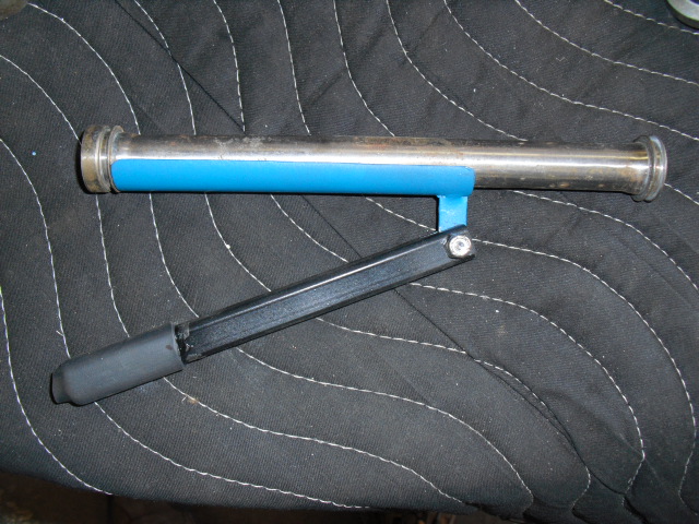

I made my own little tool, a piece of conduit cut in half. The trick is to use something that pushes on the edge of the tube (not the body)

Corventure Dave on this forum Sells these Tube removal tools, I use them all the time, works good and No dents in the tubes

davemotohead wrote:Corventure Dave on this forum Sells these Tube removal tools, I use them all the time, works good and No dents in the tubes
Available at the Palm Springs, Fan Belt Toss only... or from Clarks Corvair parts anytime.

Buy the tool. I got mine from Clark's to replace a bent tube. Replaced all of the tubes (since I was in there) and the tool made it so much easier. The tubes slide right out with a little tapping from a hammer and you don't have to worry about damaging them.
