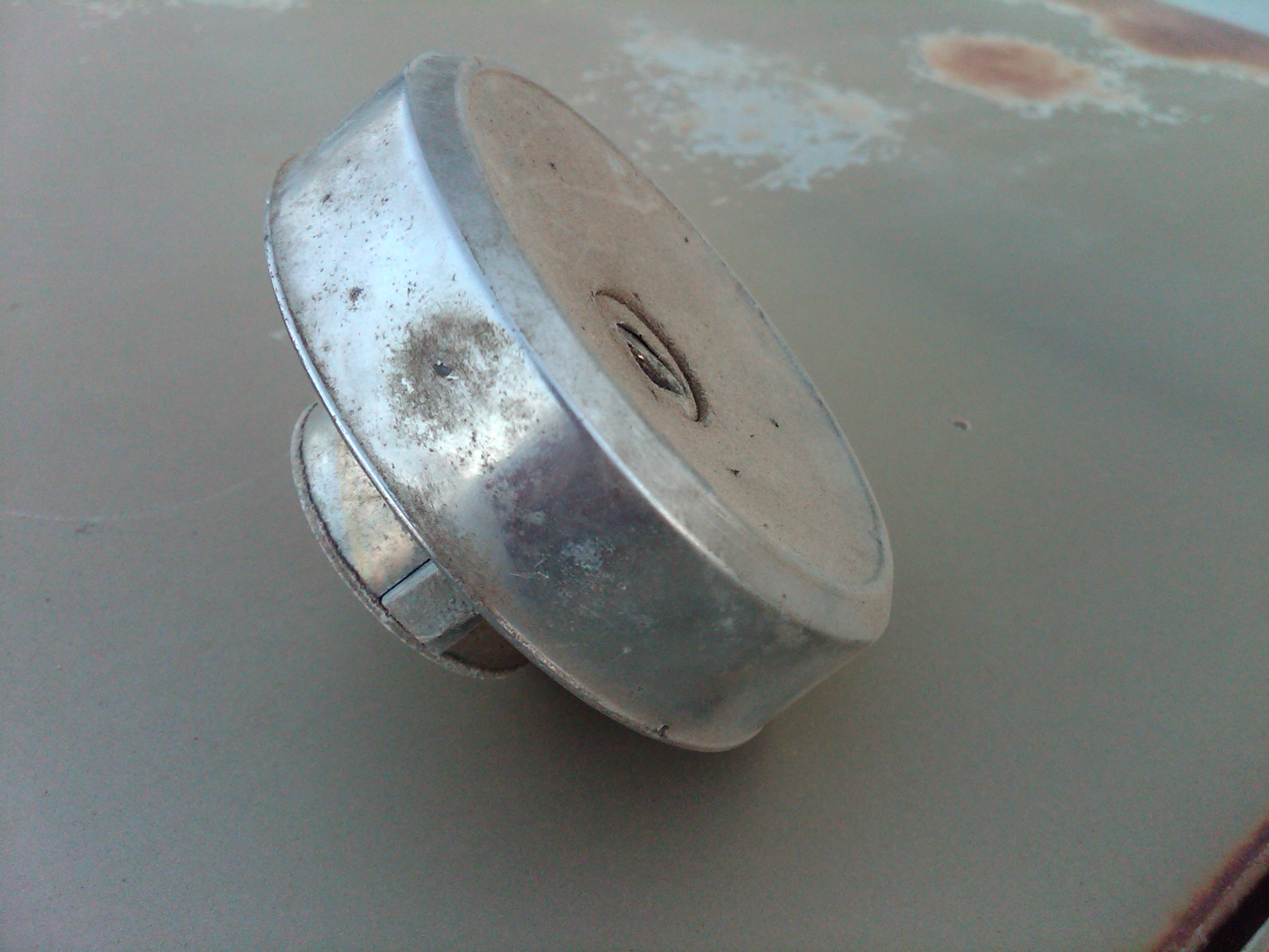

Next up is rebuilding the carbs and cleaning out the gas tank. Still waiting on the key for the gas cap
