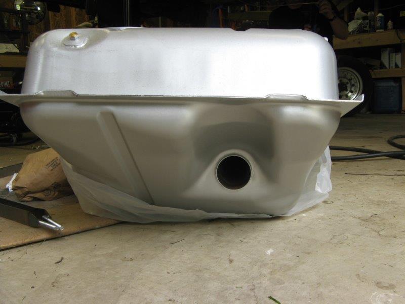

I guess it is because it is Crazy to INSTALL a Gas tank with a Hole in it.
This 1964 Corvair 95 FC Van belongs to Bill. He ordered the Complete Deluxe Forward Control gas tank replacement kit from Clark's.

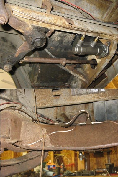

He already had installed the new Dual Master Cylinder and new brake lines to the block on the front cross-member when I stopped by.
I helped with the front to rear, and both rear wheel brake lines. Then it was time to install the new tank.

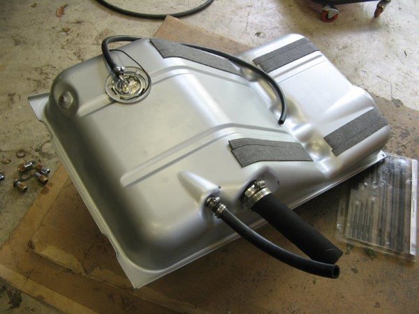

You do Not want to Pre-install the Filler Neck hoses. You Do want to Pre-install the sending unit and the fuel line hose from the sending unit and have it hanging near the right rear of the tank.
Temporarily Tape the grounding wire from the sending unit to the Right Front corner of the tank with whatever tape you have. There is room to hook it up After the tank is in. Had to use Spray Adhesive to put on the Tank Anti-Rattle strips.
In the picture above you can see, the tank sending unit wire connector, where the tank straps hook up, and where the ground wire goes.
