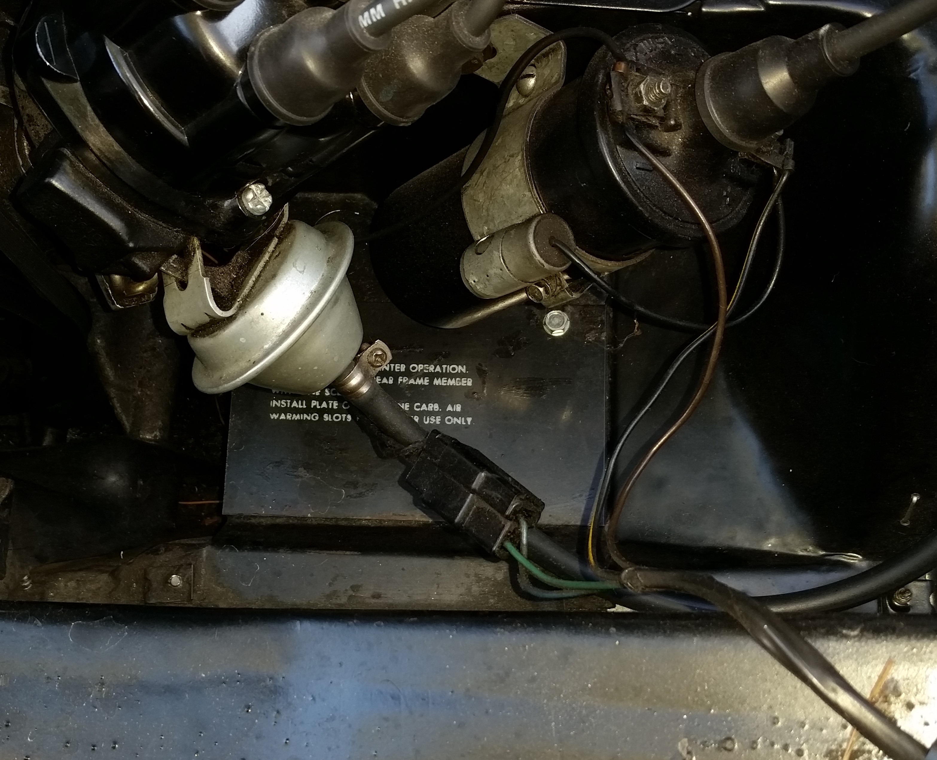

:think: :idea: I always thought that the coil would run much cooler if it wasn't bolted to a stud that projects from the right cylinder head. There must be some heat that is conductred from the head to the coil bracket and to the coil. If it was to be relocated to a mounting point on the engine compartment perimeter frame — away from the right cylinder head — the coil may run considerably cooler.
This simple relocation may reduce considerably the amount of heat and vibration the coil is subjected to, which could increase the operational life span of the ignition coil.
Re: missing and bogs down after 15 minutes driving
:goodpost:
I concur, wholeheartedly! Unbolt that thing from the engine and onto the body!!

That sounds like a good idea to get the coil off the engine. There is plenty of room to remount as your pictures suggest. That will be the next task. Also, the engine heating covers were removed for cold temperature driving. I pressed the sheet metal closed but they still do leak some hot air. I will get the set of plates that say "Remove for cold temperature driving" and leave them in. Being in California, getting all the heat out from the baffle vents is the way to go.
