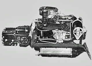

Well, what exactly is the power pack? I've never heard of it although that may be because I'm pretty new to Corvairs. as far as having more money in your car than is worth I would say if you like it and drive it then just enjoy it.
Re: brake line replacement
The term "power pack", or "power train", is essentially a term used to describe the combined, consolidated components in the Corvair — ENGINE / DIFFERENTIAL / TRANSMISSION. Many conventional cars that were manufactured in the 1960s have an engine in the front, a transmission in the middle, and a differential in the rear. But of course many modern front-wheel drive cars have a "power pack" in the front, while the Corvair had its "power pack" in the rear.
In a Corvair the "power pack is easily removed as a single assembly. The fuel lines, wiring, linkages and final drive components must be disconnected. Attachment nuts must removed from three points, and then the "power pack" can be lowered as an assembly from the vehicle.
The attached pamphlet demonstrates the removal and installation process of the Corvair "power pack".
- Corvair and Corvair 95 Power Train Removal & Installation.pdf
- (3.35 MiB) Downloaded 177 times
