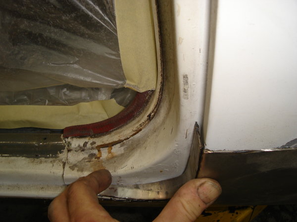

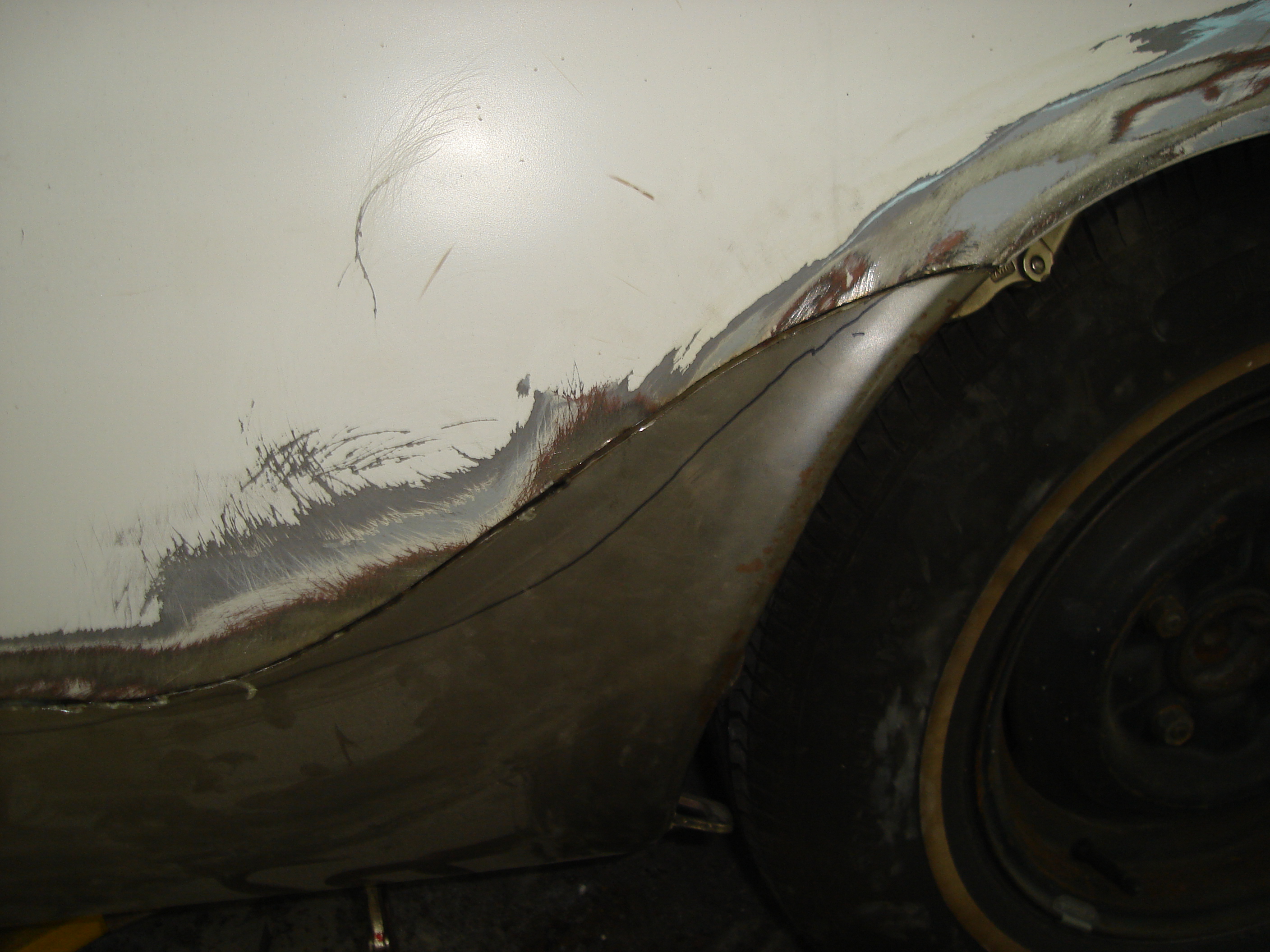

The early Clark's early Corvair patch panels I received and installed about 6 months ago were mediocre compared to some of their other panels (The late front fender lower patches are excellent for example....up there with the best I have seen regardless of car type as I have worked on many makes). The curve is not exact on any of the 4 pieces. Details are not as sharp and defined as factory. Edges particularly on the front 1/4 panel sections at the door opening are not well defined. Usable yes. Better than hand forming? Maybe it depends on how much you need to replace and your skill at such things. Assuming at least a moderate skill level in weld in fabrication I would say if you need to replace much of the wheel opening detail with the patch then it is likely easier than hand forming. Mostly the panels can be carefully reshaped and massaged to give a pretty good over all fit.
To use the patches I received all the way into the door opening (to where the factory outer 1/4 panel ends) required 2 things:
First the flange that will sit inside the door opening at the bottom of the post was about 1-1.5 inches wide when the factory 1/4 is more like 3/8 wide in this area. The patch was also not even along the edge (better to have more than not enough I guess) not a big deal really. the forming of the sheet metal through this curve is a little lumpy.
Second, the corner where the 1/4 panel skin turns in onto the post by the rear and lower corner of the door is around 90 degrees and the edge is nearly square from the factory. The patch panels edge here is more like pencil round, OK thats a bit of an exaggeration, but quite round. The presented a challenge on the car I was repairing. On one side I was able to retain the entire factory flange, replacing only the outer face welding roughly 1/4 away from the door opening. The car was rust free in this area. On the other side the original was not as good so I ended up using the patch piece including the flange, but, I had to cut the flange off the patch and weld them into the car as 2 pieces so I could weld the door opening edge and grind it square. Here are a few photos from that job.
Note that the patch is already sliced at the front and top at the corner to reshape the curve some. Imagine how round the top edge of this corner would be if the slice was not there....like I said pretty round
After slicing away the flange and fully welding the opening edge.
Ground to shape.
Rear of L 1/4 patch into wheel opening fit up with some massaging. The shape and definition around the wheel opening was a little weak and a hair wide across the flat in the center.
