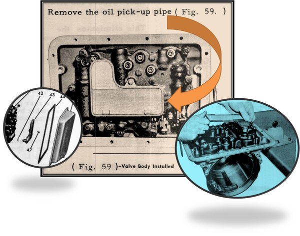

You didn't mention investigating the second possibility. From your description it does sound like something is mixing air with the oil and causing it to foam. If the oil level is not high enough to cause the planet carrier to be "stirring the pot", something else may be injecting air into the oil flow and causing it to foam. Did you pull the oil pan and check the oil pickup to see if it is loose or split in a way that could be doing this?
As shown in the illustrations below, there is an O-ring seal [42] in the valve body that provides a seal for the oil pickup [43]. A screw [47] is used to secure the oil pickup. If the oil pickup is loose, or if the O-ring seal has deteriorated, or if the oil pickup has split, it may be that air is being introduced into the oil flow as the oil is drawn into the system by the pump. This could be a possible cause of foaming in the oil.
If the problem is not a oil pickup issue, it could still be an improperly measured, overfilled transmission...

Thanks for the links Brad, I will check them out. :tu: The first thing I did was measure the dipstick & it was 19", now when I had the pan off I didn't check for anything because I didn't know what I was looking for. By the way your last two replies didn't have any photo's or illustrations, just some little symbols.
Re: Tough little engines.
64powerglide wrote:...By the way your last two replies didn't have any photo's or illustrations, just some little symbols.
:dontknow: I restructured and edited my last two posts to embed the images using a different method. I'm not sure why they weren't visible on your PC. Are the images visible now?
The fact that you have a 19" dipstick shows that your Powerglide dipstick was intended for a 1960-64 Powerglide transmission. The question concerns the length of the dipstick filler tube. If the transmission, or just the filler tube, is a 1965-69 unit, the dipstick itself might be a mismatch and may not be long enough to match the filler tube length. A 1964 dipstick inserted in a 1965 filler tube would require overfilling the transmission to have the oil reach the "Full" mark on the short dipstick. Without knowing the correct length of the filler tube to match with a 19" dipstick, the only way I can imagine to check this would be to measure six pints of transmission fluid to pour into an empty oil pan. Then start the engine and check the fluid level reading on your dipstick. A properly matched dipstick and filler tube should produce something close to the FULL mark on the dipstick with six pints in the transmission pan. If it measures well below the full mark, you may have a mismatch with a dipstick that is too short for the transmission filler tube. Adding more fluid to bring the level up to the full mark under such circumstances would in fact overfill the transmission and would cause the foaming you described earlier.

I see how the screen comes off now. Sure hope that O-Ring is leaking & letting some air in, that would be an easy repair!!!
