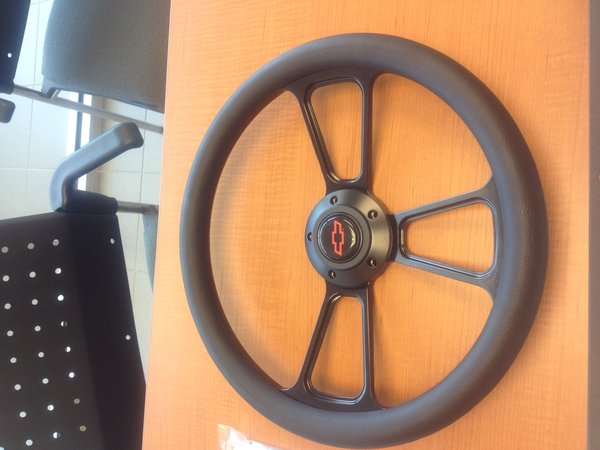

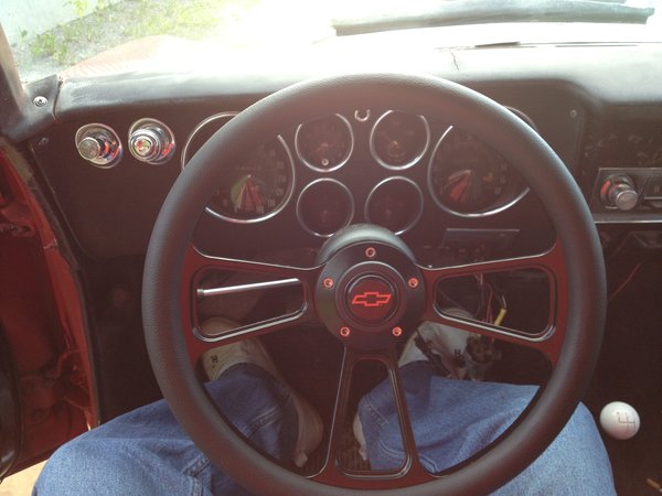

My purchase was from an eBay store "forever sharp" I believe, they were super easy to deal with and everything came packed super well.
Was pretty affordable too if I remember. The only negative, is that the wheel lines up EXACTLY in front of my Speedometer so i have to "look around" to see how fast I am going, thankfully, I never care, I just giver! :rafman:
Pics:

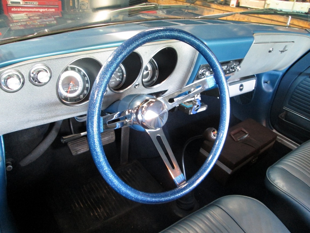

I went the nostalgic route on mine. Wheel is a 15" Mooneyes California Metal Flake Steering Wheel with an adapter from Clarks. The cover on the adapter had to be shaved down cause it hit the steering column.. Plus the wheel sits a lot closer to the dash so the turn signal lever had to be bent a tad cause it was close to the wheel. But other then that I like the wheel. The car now feels like your driving a go-cart!
