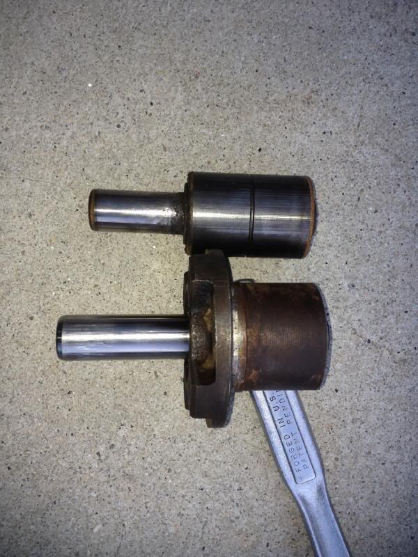

Ok, I got the new bearing from Clarks and the shaft on it was longer on than the one on the original bearing. I figured this was not an issue as the excess shaft would be recessed in the engine cover and there didn't seem to be a shoulder or lip to stop the shaft from going through. Here is the original (short shaft) bearing and the new (long shaft) Clarks bearing with the flange pressed onto it.

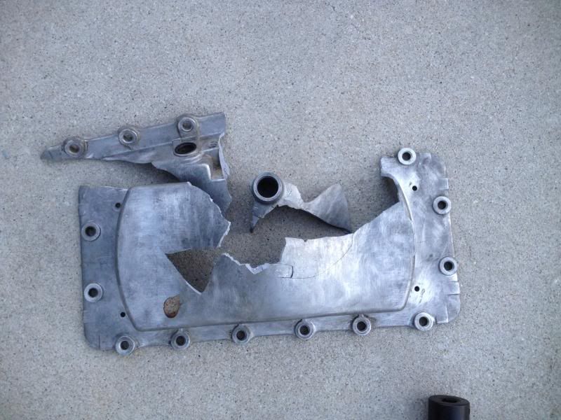

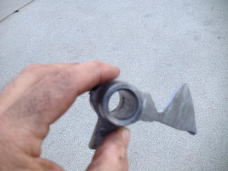

Here is what happened when I tried to press the bearing in to the engine cover.
After the fact, it seems there was more lip than I thought.

1. Is the longer shaft the issue? Should I have called Clarks and tried to get a short shaft bearing? Did I order wrong?
2. Am I going to have the same problem if I get another engine cover that needs a a shorter shaft? Is there an engine cover that takes the longer shaft with no problem?

Wonder How much he could get for his core? :rolling: If you look at the new bearing you can see score marks on it from the resistance from pressing it in,when you heat the cover and chill the bearing,the hot aluminum expands and the cold steel shrinks making an easier press fit and does not score the metal on either part,once the aluminum top cover bearing surface is broached the bearing will eventually move when the engine gets hot and the top cover is ruined. ALSO, your top cover has 4 extra holes in it at each end? was the baffle cut under the cover and screwed on to the top?

Yes, the baffle was screwed to the top. I suppose that is not normal?

NOPE! that is an old racers trick to only use one gasket when removing the cover,show a pic of the baffle plate? get a new top cover with baffle as that old modded one should be replaced as well,,a lot of the trimmed baffle plates got sucked into the crank!
