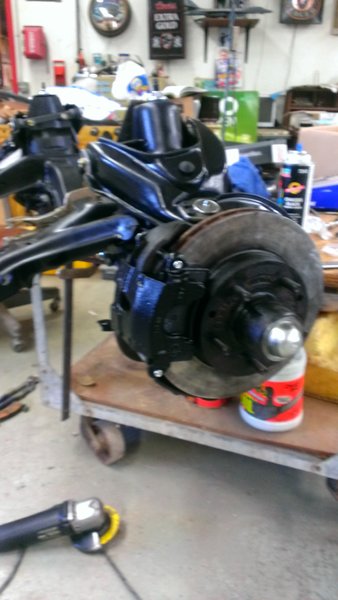

Well college break was event full for my 65 corvair. I found out that the car got invited to the Winterfest of Wheels in Sioux Falls SD in Feb 7-9 the show proceeds will go towards a Cure for Kids cancer.
I have had the intentions of rebuilding the front end on this car sense nationals and finally found the time to get the project going.
the project is to replace and paint all front end ball joints and rubber joints. the other side of this project is to fit the disk brake set-up and the 2 inch drop spindle kit to the factor corvair suspension.
here is a few photos to of the front end build. will be putting the suspension in the car hopefully on Sunday.

you bring up some good questions that I had to work around brad.
the Monte Carlo and S-10 are basically the same front spindles. I talked with a local hobby racer and first about pricing the s-10 kit and he informed me that the Monte Carlo kit would be the same thing and Cheaper. reason for this it the Monte Carlo is used on the dirt tracks and the spindles used by many racers are the 2 inch drop kit. Then the guy went and told me that he had a kit with hubs and everything in needed for the spindles and the brakes. The price he sold me was 150 for both spindles, hubs bolt pattern 5 on 4 3/4, and the front brakes.
the mods that I had to do to the spindles where not to difficult. nothing a hack saw and grinder couldn't handle. the ball joint holes and tapper are the same as the corvair but the issue is the depth. top and steering ball joints would be modified on the spindle to accommodate the corvair joints. the lower ball joint I went with using a stock Monte Carlo ball joint and cutting the lower a-arm and adapting a new sleeve to press the ball joint into the lower A-arm of the corvair.
the gain to this setup is I spent $250 total and a weekend of figuring things out. and maybe a 12 pack lol
the corvair front end will be widened by around 2 inches
of course disk brakes
local parts stores carry plenty of parts for Monte Carlo
the stock corvair spring is still used
the downfall is the speedo cable. there is room to drill a hole into the spindle to adapt the cable. but for the time and effort i would just install a magnetic pickup on car.
on my corvair, i already have Digital gauges and have installed a pickup kit before knowing I would due a mod like this.

Have you checked to see if the caliper will hit the upper A-Arm in turns with the suspension loaded/unloaded?
Re: 65 disk brake and drop kit project
only issue we had was the little flared lip on the upper A-arm of the corvair would contact the spindle where the dust plate was bolted up. this area I just ground down a little and I have full travel left and right. I gain clearance when the suspension is loaded.

here is the car with the drop kit added and the disk brakes installed. I still have to get the suspension broke in for a few miles before I get the car aligned but I did take some measurements before and after the kit was installed.
stock measurements for width on center tread was 57 1/4 new width is 58 1/2
here are a few pictures of the spindles and the clearance issues I ha to overcome. the clearance gets better as the suspension has weigh on the car. the photo was taken with no load. the other picture is the size of the lower ball joint that needed to be installed. there was no issue with this install. took me only about an hour to do both a-arms.
the measurement I took on my above post was taken after putting a 1/4 inch toe in with no suspension load. so I expect that to change but it gives an idea of the width change.
On the bottom sleeve, did you just butt it up to the bottom and weld or cut a hole to fit it in?
