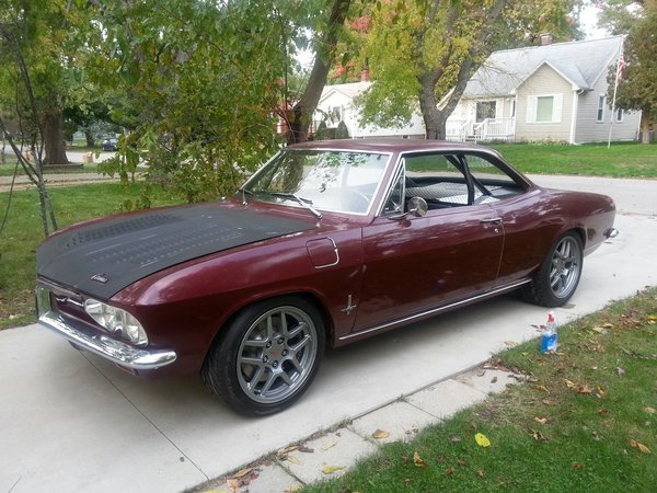

The engine is a 2011 6.2 liter LS3 with a GM LS HOT cam I installed. This is basically the same engine as installed in the 2010+ SS Camaro with a little more top end power with the cam change. Lets just say it has adequate power for a Corvair! I assembled this motor from a new long block that my local dealer had and couldn't use and an intake manifold a friend had taken off his Camaro for a supercharger upgrade, so I got into it at a good price. It is rated at 480 horsepower by GM.

Plenty of room for the stock Corvette Z06 17/18 inch rubber-I just cut out the corvair shock mounts in the rear for clearance. Front is Corvette C5 with a Mustang 2 steering rack -the rack is stock but the front corvette suspension cross member is narrowed about 5 inches to account for the narrower Corvair track width versus Corvette. I added mount points to the corvair front frame rails to bolt the corvette front end in similar to the original corvair front suspension.

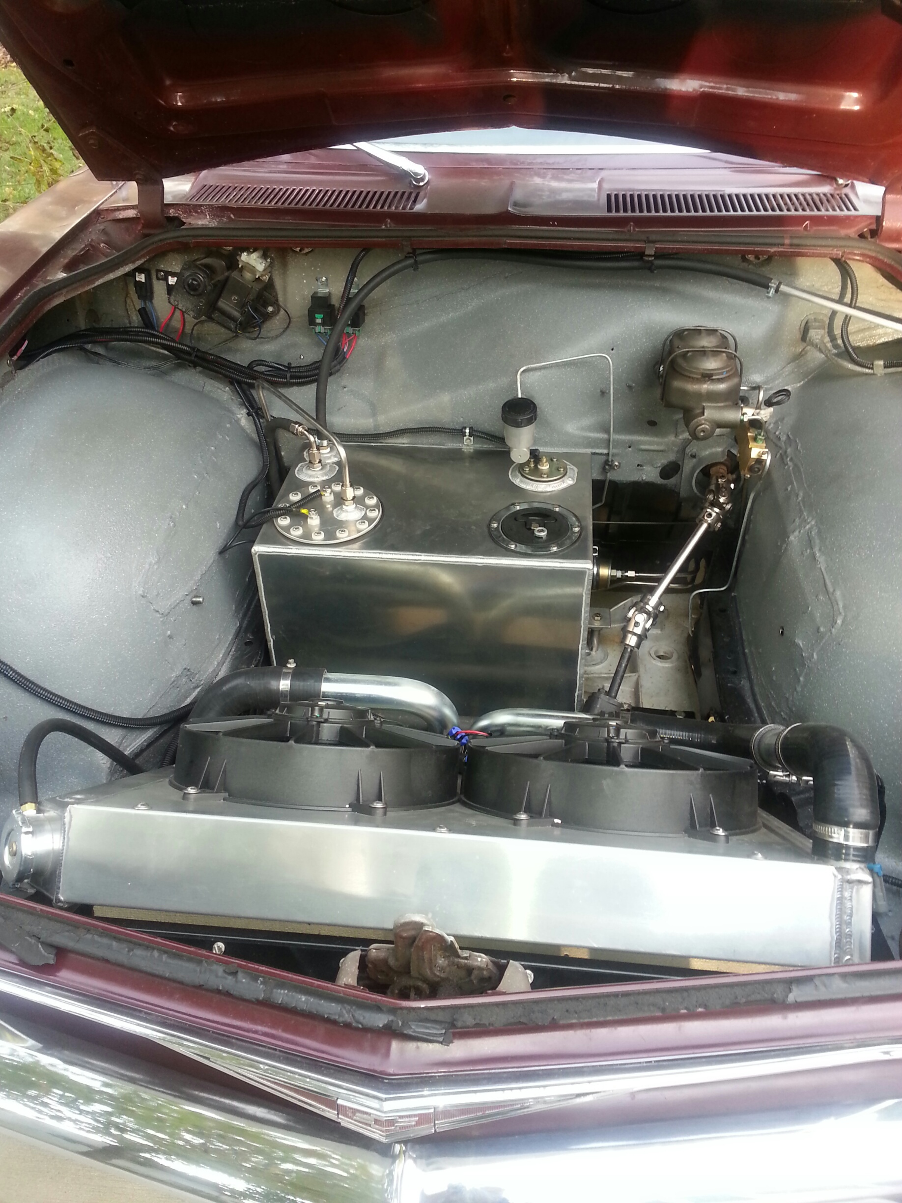

The radiator is a custom 1969 Camaro aluminum unit with two high flow spal fans-it cools well with 1.5 inch cooling (water) tubes to the motor. These are silicone hoses from Speedway Motors for bends/hookup with aluminized steel exhaust tubing for the long runs under the floorboards . The hot air is exhausted through the louvers on the hood, but I may go with a GT40 style extractor vent on another hood I have. You may notice the front end lower valance is not cut at this point-cool air enters from under the front like a newer Corvette- I am adding an air dam to the car but I don't have plans to cut vents in the front valance unless cooling becomes an issue. The overall cooling design in front is very similar to a C5 corvette.

I am planning paint and body work this spring, thinking about a black paint job but the Maroon color is nice also. The car I used as a donor is rust free so I don't have to spend any time chasing rust-unusual for a Midwest Corvair for sure! The floor pans in this car are the nicest I have ever seen.
