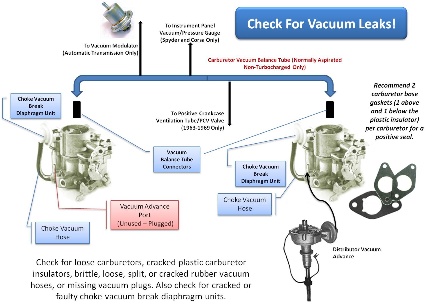

The insulator and gaskets are shown on the right in the following illustration, and in the Clark's Corvair Parts catalog page below...Edelbrock Edelblog wrote:Question:

Left-click on the image with your mouse to enlarge...
Part number C506: CARB BASE INSULATOR-THICK "PLASTIC" WE SUGGEST 2 "PAPER" GKTS (C506H) WITH THESE
