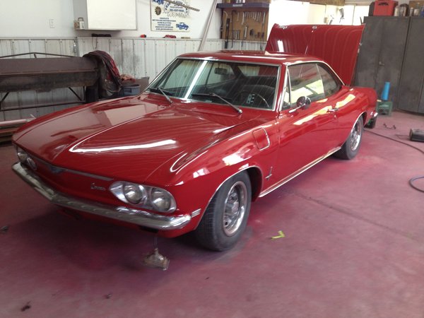

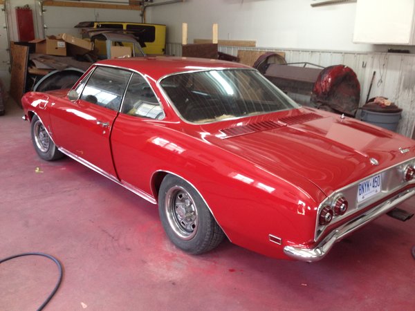

Already got all of the lights to work except high beams (not getting power to the light) and the side markers (hoping I just need bulbs) The reverse light switch apparently was siliconed over.. so I am not sure how desperate I am for them considering its a nice weather weekend warrior car. Seat skins are at home, looking for someone local to restructure and install those and while there away I will plan to replace the carpet and rear package area with speakers likely. Enjoy the pics..

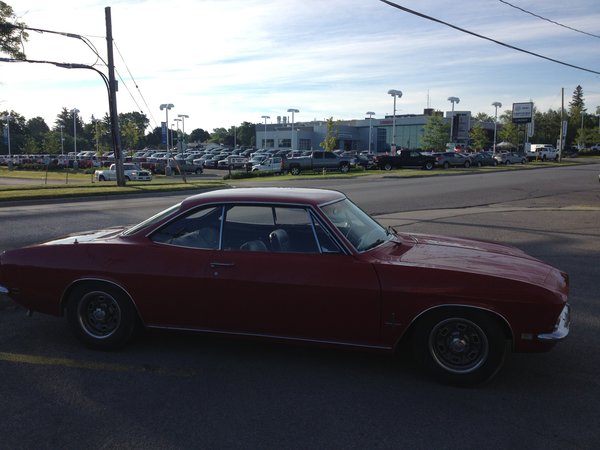

So!!! Hows everyone lol... This is almost a year late.. Lots has happened, well not really with the Vair, but I bought a new place April this year. We are just finally settling in, and I got myself a garage this time!! I did very very little with the car over winter (lack of space at old house) and have decided this year will be more about re-vamping the interior, and maybe some new tires, and drive the tail end of the year.. if not.. no big deal. I just want to enjoy getting it put back together. I will attach some pictures below, first thing i did was remove all seats and carpet and front seat belts. I noticed the floor was pretty good, some PO patchwork still feels good, but there are two small areas of "day light" just back from the Fresh air vents on either side I will weld up asap before carpet arrives. I decided against going with the 68 padded radio surround, and temporarily used "plasti-dip" paint for now so its all one colour <(I live in Canada lol) a couple more coats and it may hide well.. regardless.. I dont really WANT to repaint the whole dash, its not a trailer queen just a driver.
Sorry for taking so long to get back to here, hope you guys enjoy the pics.
