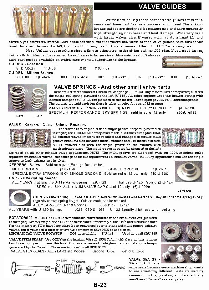

Part number C5857A: TEFLON INTAKE VALVE STEM SEALS-SET 6 ONLY GO ON INTAKE VALVES!!YES-WE'RE SURE!!
Weight: 0 lbs 2 oz
Catalog Pages(s): 6,17(5)
Price: $ 15.05
Part number C1030 (Regular): SEAL-VITON-VALVE STEM-SET 6--IF ASKED ONLY GO ON INTAKE VALVES!!-TEFLON= C5857A
Weight: 0 lbs 2 oz
Price: $ 11.15
FROM CORVAIR UNDERGROUND - Left-click with mouse to enlarge the image...

Mark has correctly identified the reason that valve stem seals are used on Corvair cars. Simply put, they keep oil from oozing into the intake and exhaust ports when the car is parked on an incline and oil pools in the downhill rocker box.
You get a light blue puff at startup from oil down the exhaust valve stems. In extreme cases, enough oil down the intake valve stems can cause misfire due to fouled plugs on startup.
There is also the concern that car engine spend a lot of time at idle and light loads (high intake manifold vacuum), and some wear on the intake valve stems can result in a lot of oil being pulled down the intake valve stems and result in heavy restrictive carbon deposits on intake valve heads. I've seen engines like this - it does indeed happen with a granny drive cycle, bad seals, and some valve guide wear.
On the other side of the argument you have the simple fact that a tight clearance between valve and guide needs regular lubrication or it will become loose, and the stated purpose of a valve stem seal is to restrict oil flow into this space. It's a particular concern on the exhaust valves, which run much hotter and don't have the consistent strong difference in pressure to pull oil down the valve stem and keep them lubricated and cooled.
For a car, probably the ideal thing to do is break the engine in with no seals, then fit them to the intakes after break-in if you don't anticipate thrashing it enough to keep carbon off the valves. On an airplane, I can't imagine why one would run seals at all, for precisely the reason Mark mentions. In any event, there's no reason to use exhaust stem seals ever - all they prevent is a momentary puff of blue smoke on startup.
Weight: 0 lbs 2 oz
Price: $ 15.05
Weight: 0 lbs 2 oz
Price: $ 11.15
