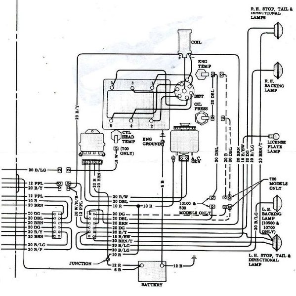

Would anyone know how many wires run to the engine compartment electrical harness. the reason I'm asking is I'am installing a twist lock stainless connector and I have to know how many pins I need.

Looks like eleven, not counting the separate wiring harness going to the starter, or the cylinder head temperature gauge lead (Corsa only). Note that a Monza or 500 only have nine wires passing through the main harness connector, because they lack the Corsa tachometer lead and because of warning light differences that exist in the Corsa only. The connector shown in the photographs is not in a Corsa (10700) since only nine connector terminals are present.
