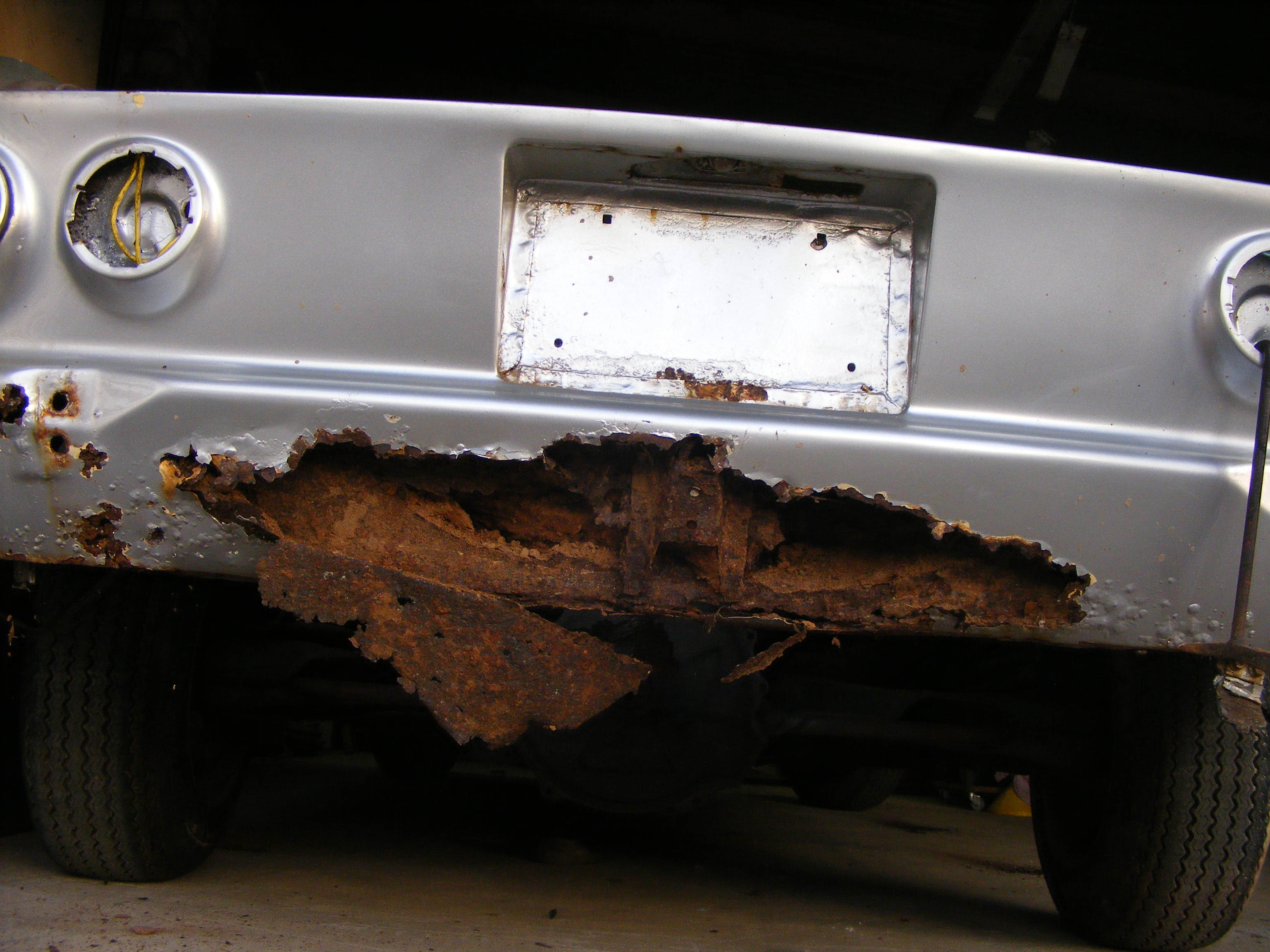

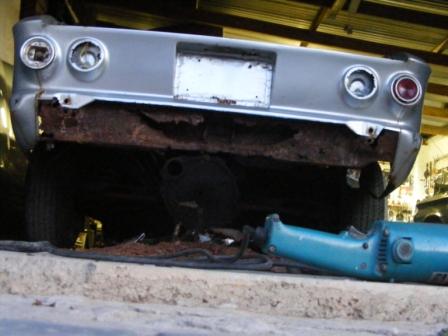

It's picture time, have taken a few pictures, these shall I say, tell a story of their own, no amount of waffling will more clearly describe what you observe. All I can say my enthusiasm has taken a bit of a dip and I wonder where I am
Well you look and see/tell me what you think

I never thought I d ever say this, but yours looks even worse than mine
These things sure know how to fall apart dont they?
Re: I HAVE FOUND A COUPE from South Africa
I was just going to say "This sounds like another "Pennsylvania Bondo Bucket" story.mart wrote:I never thought I d ever say this, but yours looks even worse than mineThese things sure know how to fall apart don't they?
At least yours wasnt passed off as "fully restored".I havent even looked at my doors yet, but am expecting the usual botched cover up

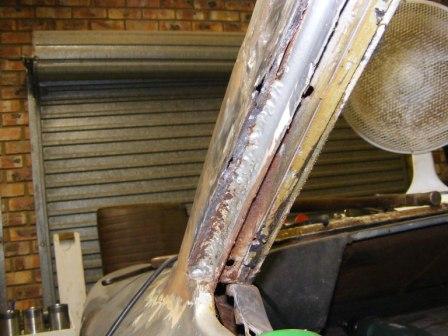

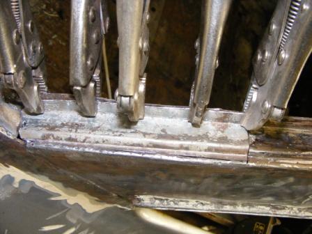

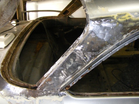

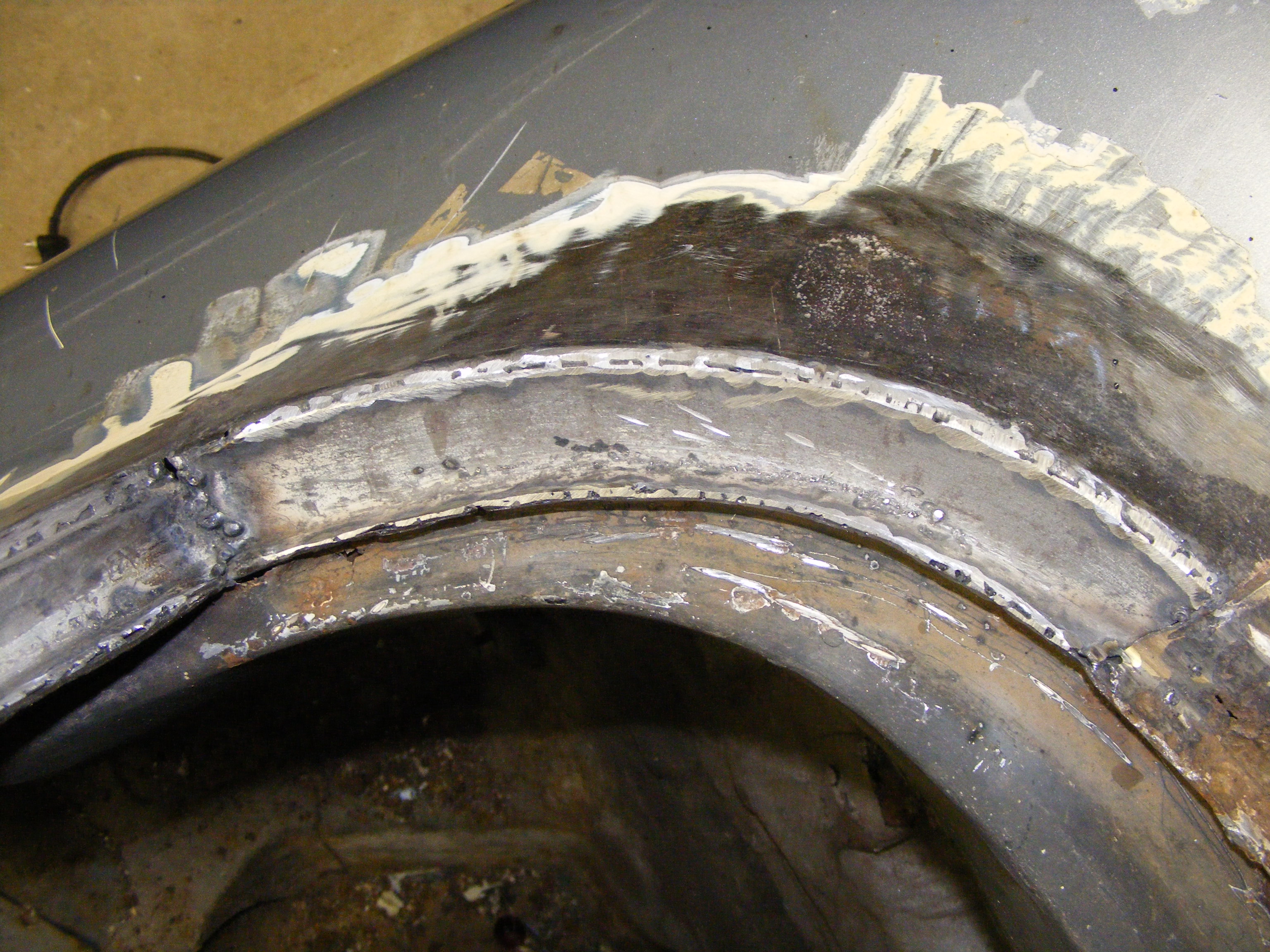

"Ja nee Boet let the repairs begin" Ok so have made the first attempts at replacing some window channeling, NO! please do not ask me why I chose one of the most difficult sections to start off with,
I'm a sucker for punishment
. Thought, well if I can manage this I should be able to do just about anything
First used some really thin 0.45mm chromodeck sheeting to get a feel for things and get the hands warmed up etc. That worked real easy, then used some 1.0mm flat sheet-metal, cut off of the shelf-rite shelving that I cut out of the car that was welded in place as the floor, you can see them panels in the earlier pic's. No blood, no blisters, no swearing , just patience and well see for yourself. Will more than likely rip them out by the time I get to the end and my skills have improved some. Have not done this since back in '74 when I had to plug holes in my 1st car, a '65 Mini Cooper.
Well it's a start and Mart you are a true inspiration, hats off to you my man, you have determination and tenacity! I really will need a kick in the pants every now and then. I know I'm going to drift off in other directions from time to time, so feel free to kick from time to time, PLEASE. Let me know what you guys think and please give advise/thoughts etc any input is appreciated

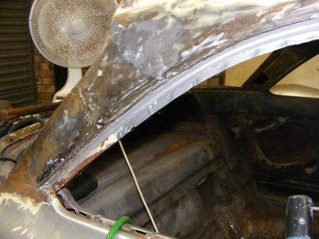

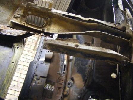

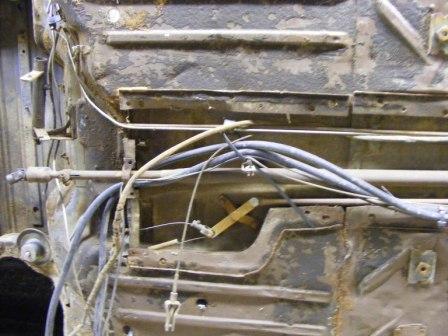

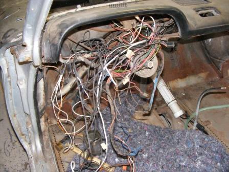

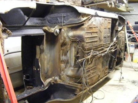

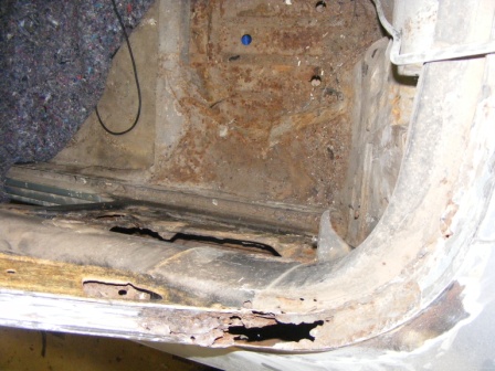

Ok!so have made a little more headway in the strip down, so I will not call it progress. However, I have been productive in the dead of night. Stress and pressure at work is massive at the moment and that means I do not get much sleep. So I get up at about 1am and work in my workshop until about 5am and then catch a 2hrs excellent sleep then its off to work until 7pm.
I am posting some pictures taken since my last posting on 24th March. I got up one night and decided I need a rotisserie to get to the underside of the car. So I started digging amongst my stash of "stuff" as it's referred to by others and put together an over-engineered but functional rotisserie. I will post some pictures of that once I have modified the few glitches I have encountered.
The rust on this car is just unbelievable, but I will fix it, I WANT a Coupe and I WILL HAVE ONE! Whilst digging the bondo out of the drip rails the RH rail has come undone along 70% of its length, so this Coupe will not have drip rails, they are GONE! The 1st picture shows the outer skin of the front RH pillar is completely rusted off. Once I started digging it was just bondo and pot scourers. Taking out the rear valence as a whole is going to be a challenge but I will keep a photographic track of how I did that. There are several panels that overlap and are spot-welded one after another but I will persevere and WILL get it right watch me!
The car is now completely stripped down and the bare shell is hanging in the rotisserie. About 1/3 of the paint is stripped down to bare metal and so far the rest of the car looks good, the entire floor pan needs to be replaced. I really hope my donors floor is still good. The car is in storage in a weather proof enclosure but man oh man its going to be a mission to get to it.
Ok! so here are the pictures will keep you guys posted on the progress, which is going to be slow as work is really hectic at the moment, I must be getting old or something

hentysnr wrote:Ok!so have made a little more headway in the strip down, so I will not call it progress. However, I have been productive in the dead of night. Stress and pressure at work is massive at the moment and that means I do not get much sleep. So I get up at about 1am and work in my workshop until about 5am and then catch a 2hrs excellent sleep then its off to work until 7pm...
...progress, which is going to be slow as work is really hectic at the moment, I must be getting old or something...
It must be something in that South African air, or food, or SOMETHING! I don't think I had that much ambition, stamina or energy when I was 18!
Now, at 60...
Chevrolet built Corvairs out of steel and aluminum. South Africans build Corvairs out of RUST and aluminum!

hentysnr wrote:Hi Guys
Cheers
Henty
How did you form that curved piece around the window?
