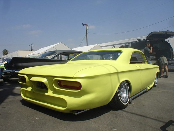

saw this on instagram today,
Posts: 4304
Re: How low is too low?
THAT"S LOW!!! looks so cool :tu:
Posts: 12142
Yeah, but the camber looks real bad even in the picture! I'll bet the handling isn't too good, the tire wear is terrible, and watch out for those speed bumps! :nono:
:eek: :eek: :eek: :whoa:
Post by freedo »
bbodie52 wrote:Yeah, but the camber looks real bad even in the picture! I'll bet the handling isn't too good, the tire wear is terrible, and watch out for those speed bumps! :nono:
Cars probably rarely driven and only on smooth roads
