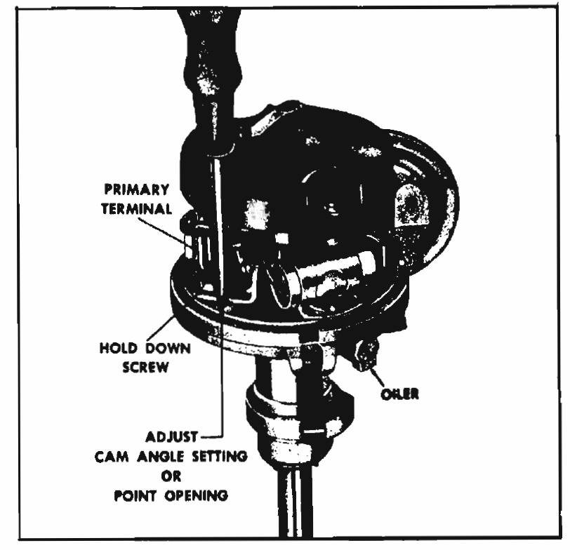

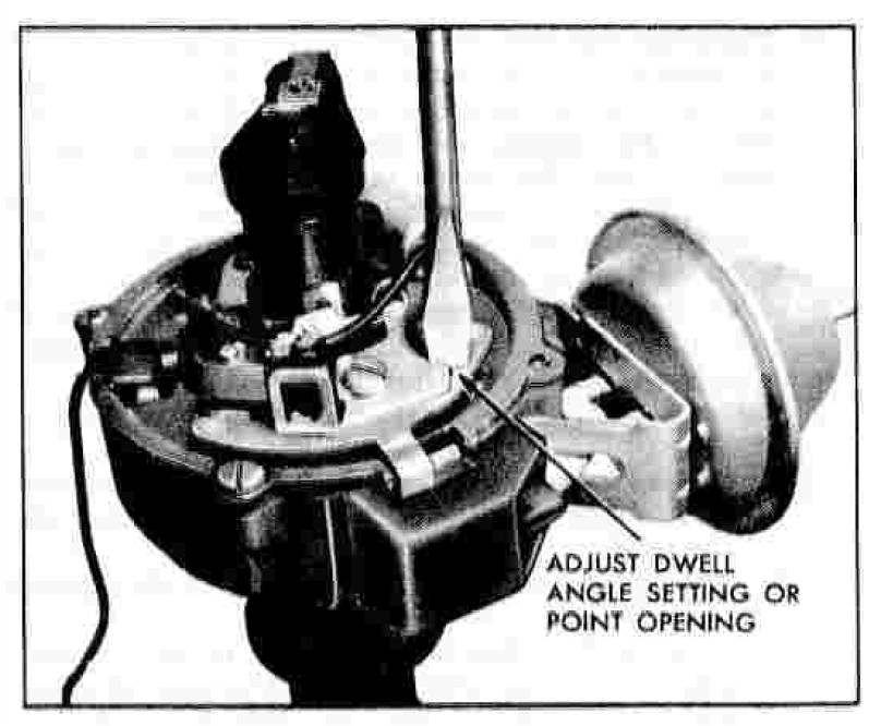

There was a significant difference in the design of the earliest (1960-61) Corvair distributors and the 1962-69 version. I believe that they are interchangable, so if you were to obtain a 1962, 1963, or later distributor from a similar engine you should be able to install it in your 1961 Corvair. Doing so and eliminating that obsolete design in your current distributor would make it easier to obtain parts also.
I have included pictures of the two distributor designs below. You will note that the centrifugal advance assembly on the early design was above the points, and under the large rotor assembly. In the later design, the centrifugal advance was relocated to a location underneath the points and breaker plate assembly. The design of the early 1961 distributor, with the large rotor and centrifugal advance assembly positioned above the points will probably prevent the pertronix ignition module from being installed. Please note that the cap and rotor for the early distributor will not fit on the late distributor design.
