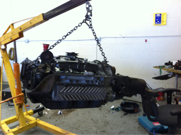

Well I got my engine in and have maybe another hour or so of work to get it running but I need to write a 10 page paper for my English class:( I'm seriously considering just working on it anyway:p

Distributed help?
Got my engine back in the car and my distributer is messed up, the bottom edge got twisted off because the oil pump was bound up. I guess I'll need to drop the engine to pull that front case off and replace the drive gear and fix my oil pump (glad the car didn't start up with the oil pump not turning)
Anyone know of an HEI distributor for the Corvair? I figure if it doesn't cost a whole lot more I might as well do that. I found a refurb distributer for $70, but if there's an HEI one in the $200 range I would probably just do that. Anyone know of any or have any experience with any?

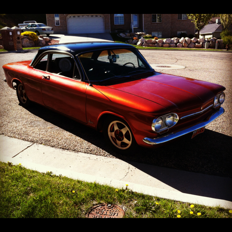

What do u guys think of the black top? (almost done, just a couple more coats)
Corvair.crazy
Posts: 966
Location: McMinnville, Oregon
Re: 63 Monza Spyder Restoration
Post by Corvair.crazy »
Another success story! Well done. BTW I love the two tone paint. :coolphotos:
