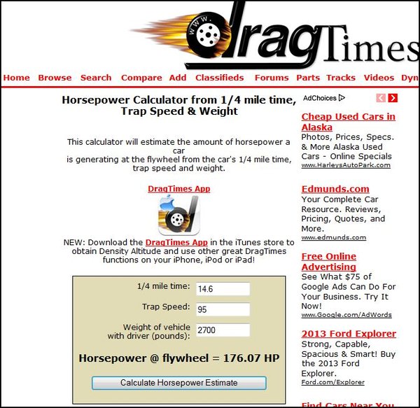

I always wanted to think that I was getting 250 hp but more realistically it's probably about 190 hp. This is with 190 cubes , ported heads with angle exhaust ,bigger cam , headers , etc , etc.
Using a hp calculator based on 1/4 mile times my car is at 176 hp
The stock engine test paper lists the 140 at about 100 hp so I'm sticking by my guns
A vair that can do the Qtr in 16.5 at 85 mph is making 124 hp. That's still as fast or faster than what most Corvairs can do.

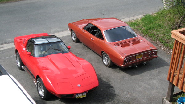

I sure wasn't infering that you'll be disappointed . I also have a Corvette with a 425 hp 383 stroker but my Vair is still more fun to rod around in.and here i was hoping for 180whp out of it,, sounds like ill be disapoinfted in performance when i finally get to drive it
I'd rather push a Corvair than drive a SaabI tune saabs for a living
If you want a good idea about how a well tuned 140 with similar mods runs , and for Grymm some shots of the tachometer
