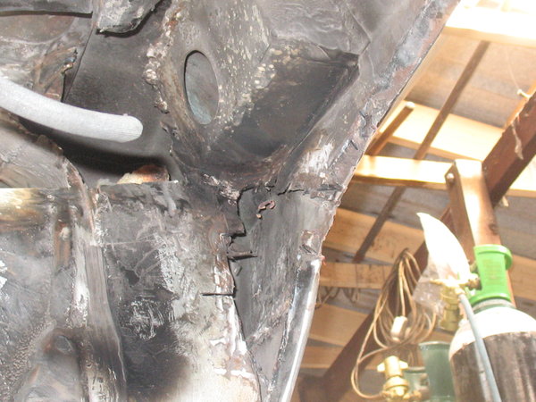

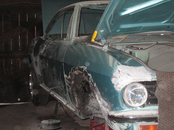

Here are some more pics of the professional repairs done in PA .All well hidden to the naked eye until I dug them out
under drivers front fender
same repair from top
pretty much as expected here

Man it sucks more and more the deeper you dig into it. :(

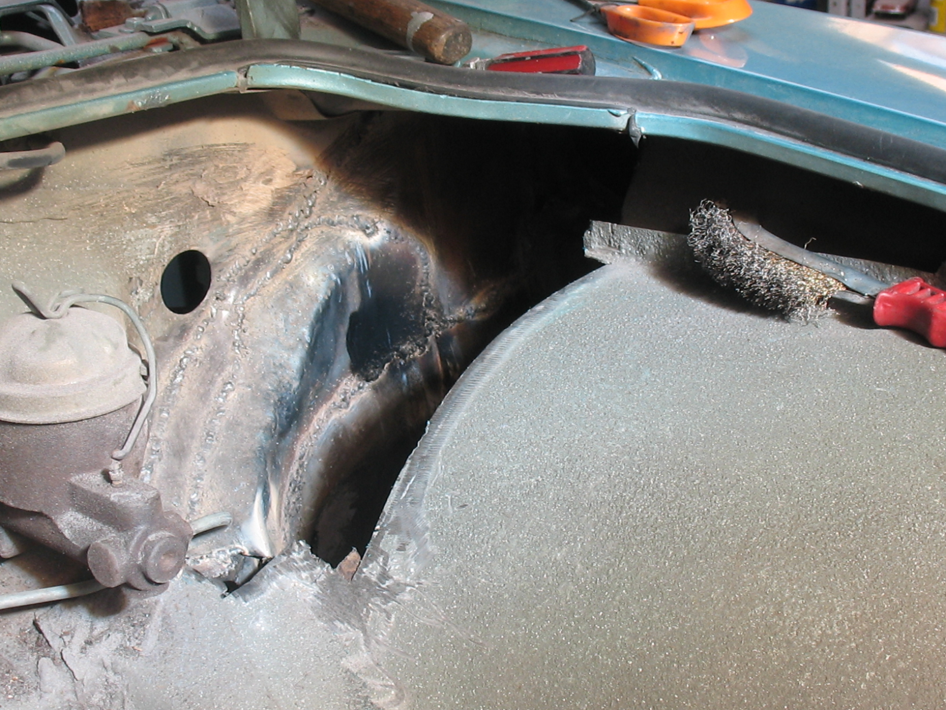

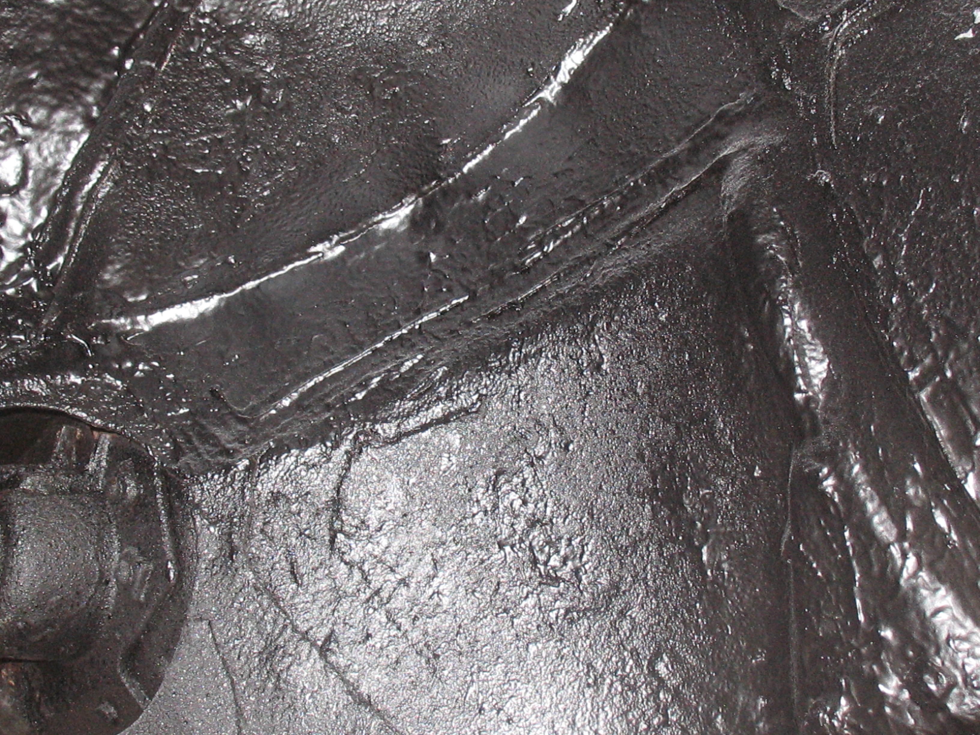

Is that a giant crack right there near the master cylinder?....
mart
Posts: 928
Re: pensylvania bondo bucket
Post by mart »
It sure is, its the seam where the inner fender joins the trunk panel, I'm in the middle of cutting it all out but its hard to get into the corners.

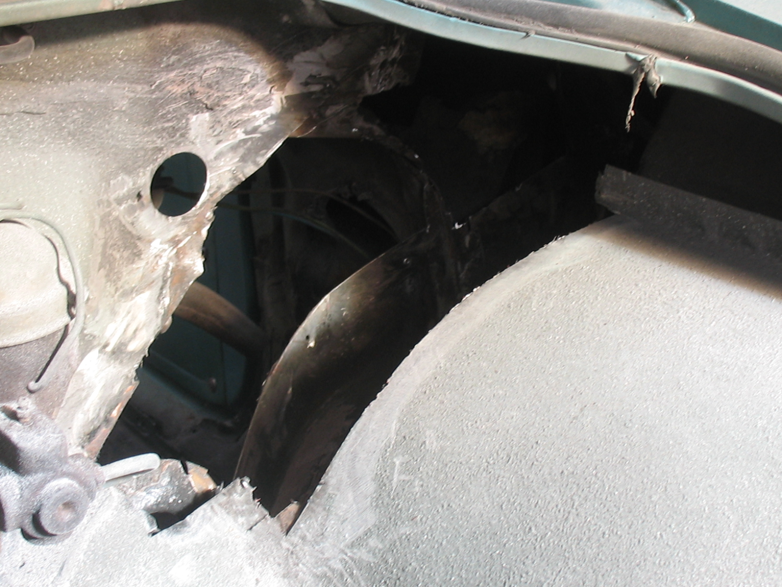

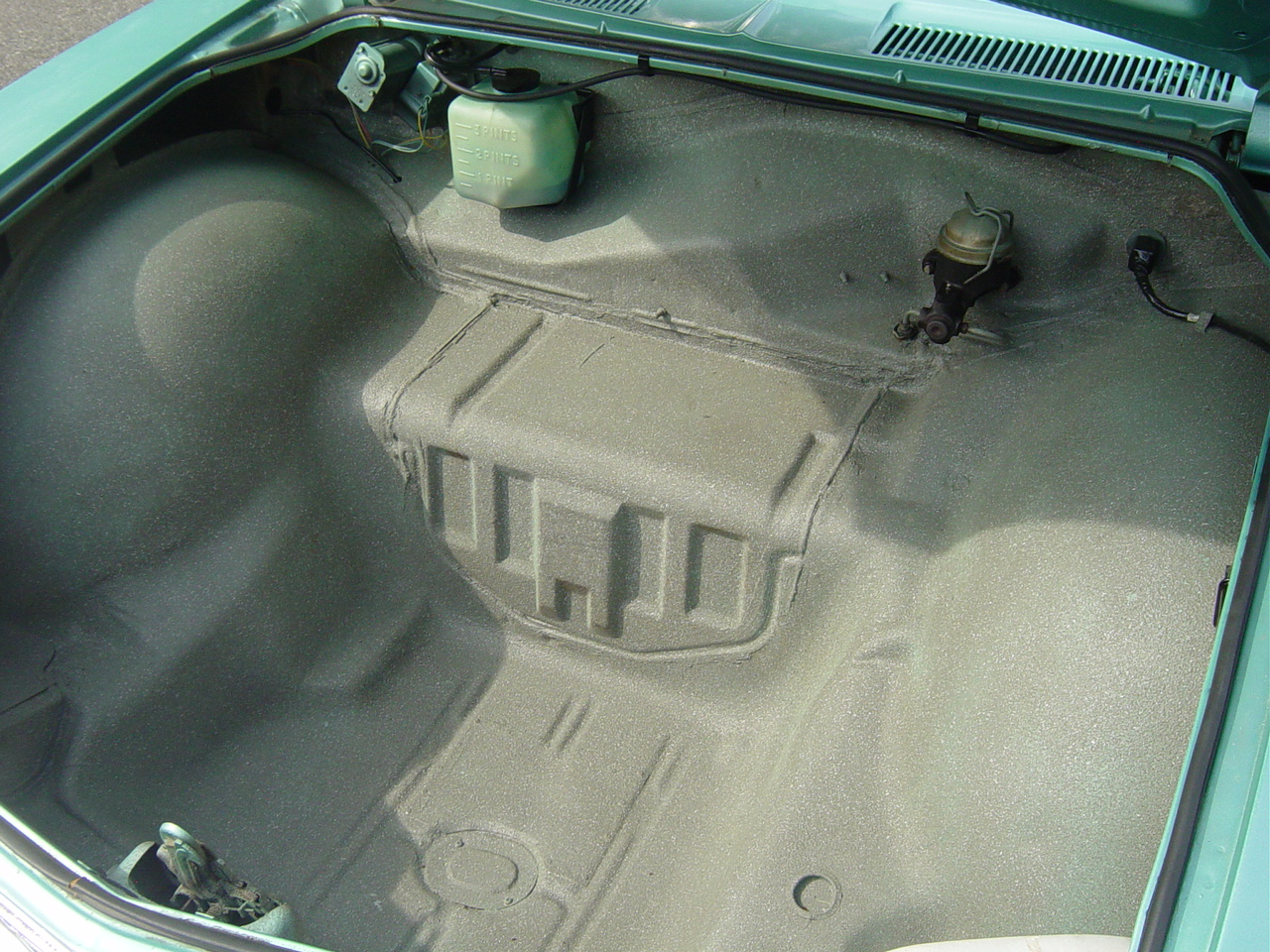

It just gets better and better
sales picture
sales picture
The reality
The reality
once the rivets foam ,bondo  and aluminium siding patches are removed
.......this is what we are left with
Aluminum siding?!?.........aaaauuuggggghhhhsssshhhhiiittttttt... *facepalm*

yep, complete with ridges and green plastic textured coating

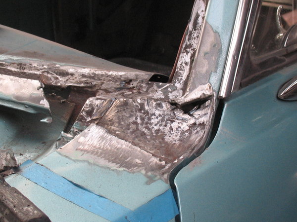

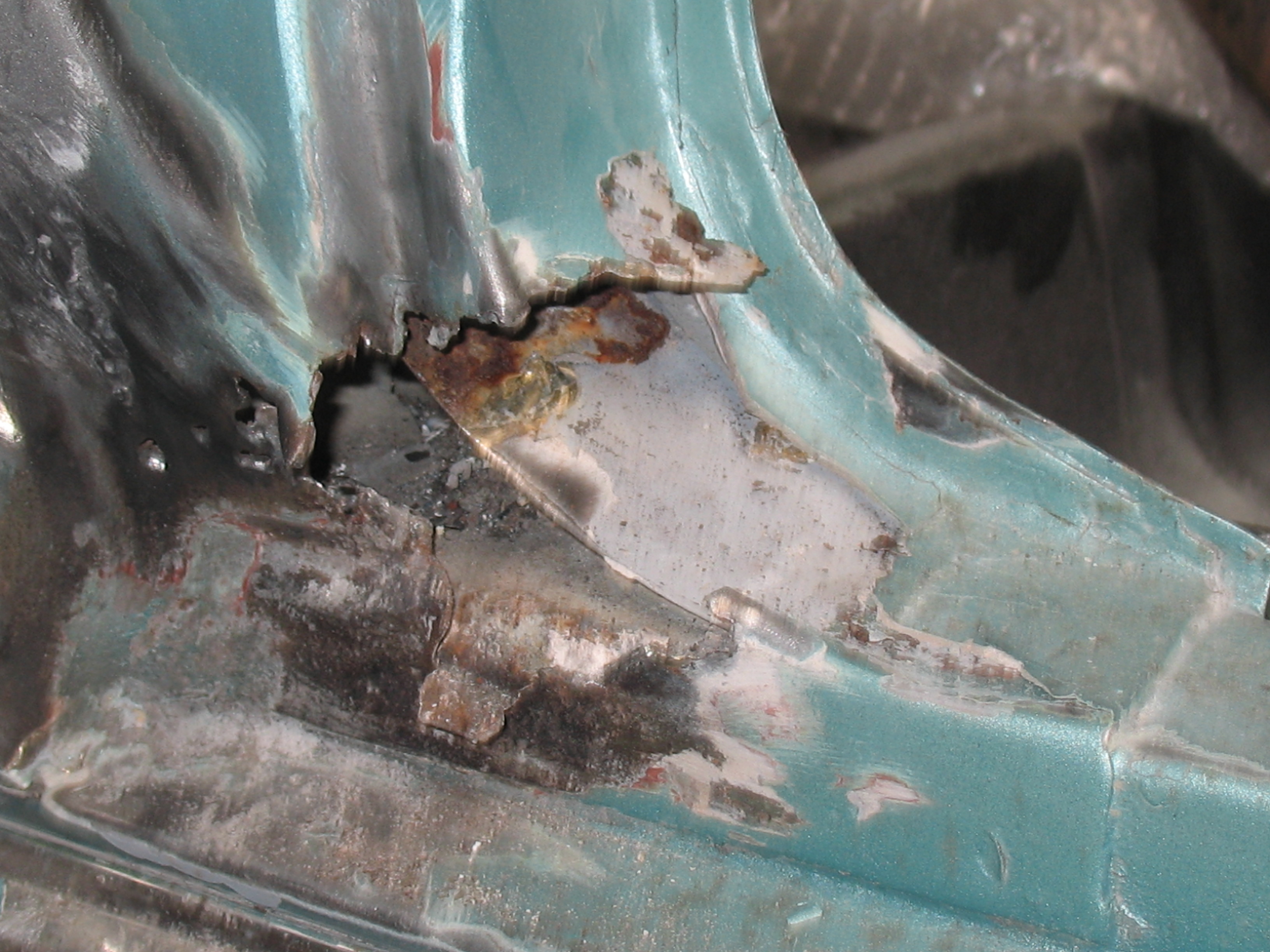

Here we go again !!!
drivers inner fenderwell repaired

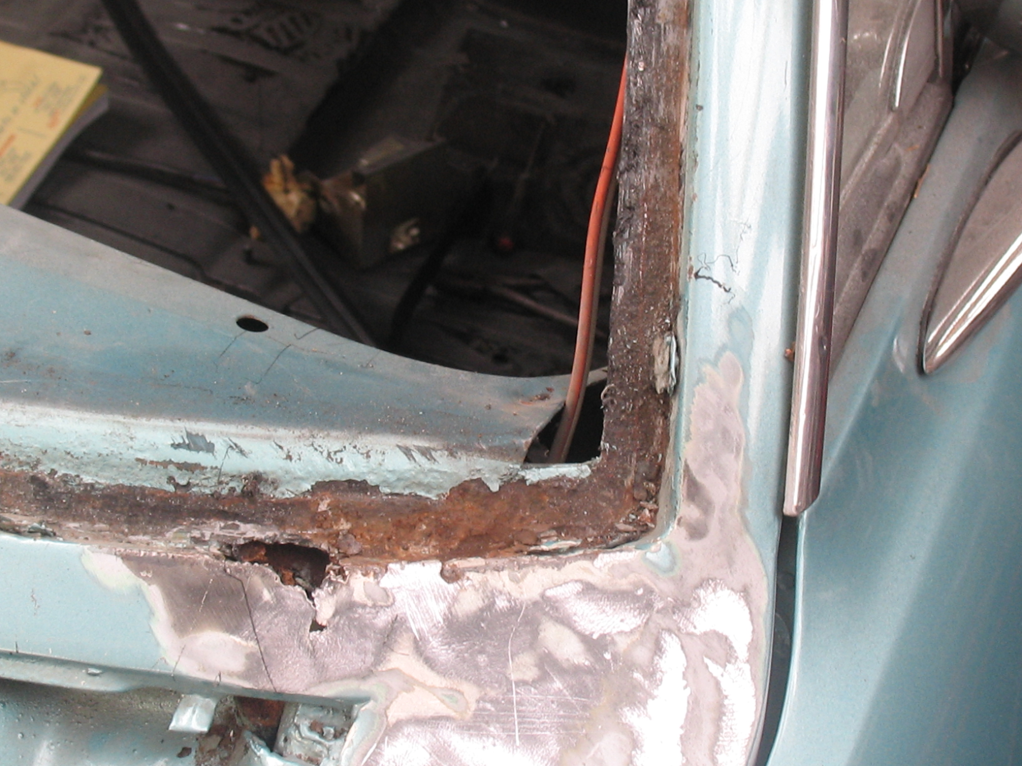

bondo removed from passenger door jamb
bondo removed from passenger screen post
