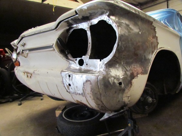

Plenty of people want r12, I looked for some when the roof air on my vintage coach was low,could only find r12 "replacement/alternative" for r12 systems.
I Wanted to convert it to 134a but didn't ,Changing the system oil was not easily done, if even possible.
Oh, Even 134a containers can be useful :eek:
