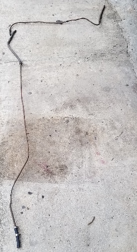

You might want to do what I did.
My friend and I bent a CUNIFER (copper, Nickel, Iron) 5/16"tubing to fit along the tank to get rid of that long rubber hose. It was attached to the sender with Gates 5/16"Barricade hose at each end. I added a GF-99 fuel filter at bottom behind the tank. I then routed new 5/16" steel lines to a square body electric pump on the frame outrigger about 1 foot behind the left seat mount, then to the metal can filter behind the left wheel. We then made a new CUNIFER line to the new 3 port T-fitting to the feed the two CUNIFER 1/4" carb lines routed in front of the fan.
First photo shows original OEM fuel line under the floor (minus about 26"of the tank hose). This is as as removed from the van. Too many rubber hoses and a very old steel fuel line for me to consider this being a reliable fuel system.
This is the current configuration when I sold the van. I didn't get a photo of the filter install at the left rear wheel, but line is routed to OEM position and the filter added in.
