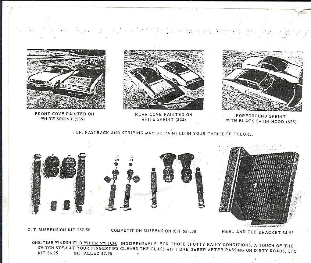

Re: FITCH SPRING RUBBERS?
I haven't found the actual instruction sheet yet but I did find a photo .
The installation is how I described it , I wasn't sure about the front Aeon but the pic shows that after you cut the original rubber snubber in half - you put the little Aeon on the shock first and then the cut down snubber.
