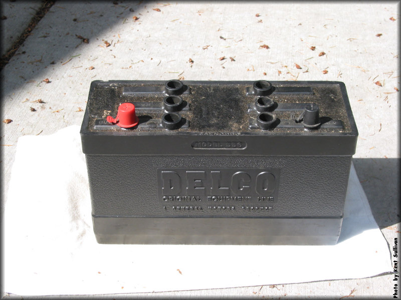

I assume "group 23" is a misprint, and you mean group 53. 53 is the stock battery for early Corvairs, reversing the terminals will mean the car will not be correct as built. The stock terminal location of a group 53 worked fine for a million + Corvairs. :think:
[/color]
When this group 53 battery is installed in the battery area both terminals are away from the engine, safely tucked up under the left quarter.
