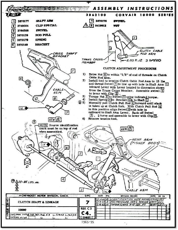

I have attached a section of the 1965 Corvair Assembly Manual as an example. Numbered fasteners in the main illustration diagrams also frequently show torque specifications as a related number surrounded by a triangle, as depicted in the above page example.
I consider the Corvair Assembly Manuals to be an indispensable supplement to the related Corvair shop manual for each model year.
Assembly manuals are available from Clark's Corvair Parts for each Corvair model year. More information can be found in Clark's online catalog on pages 243A - 243B
