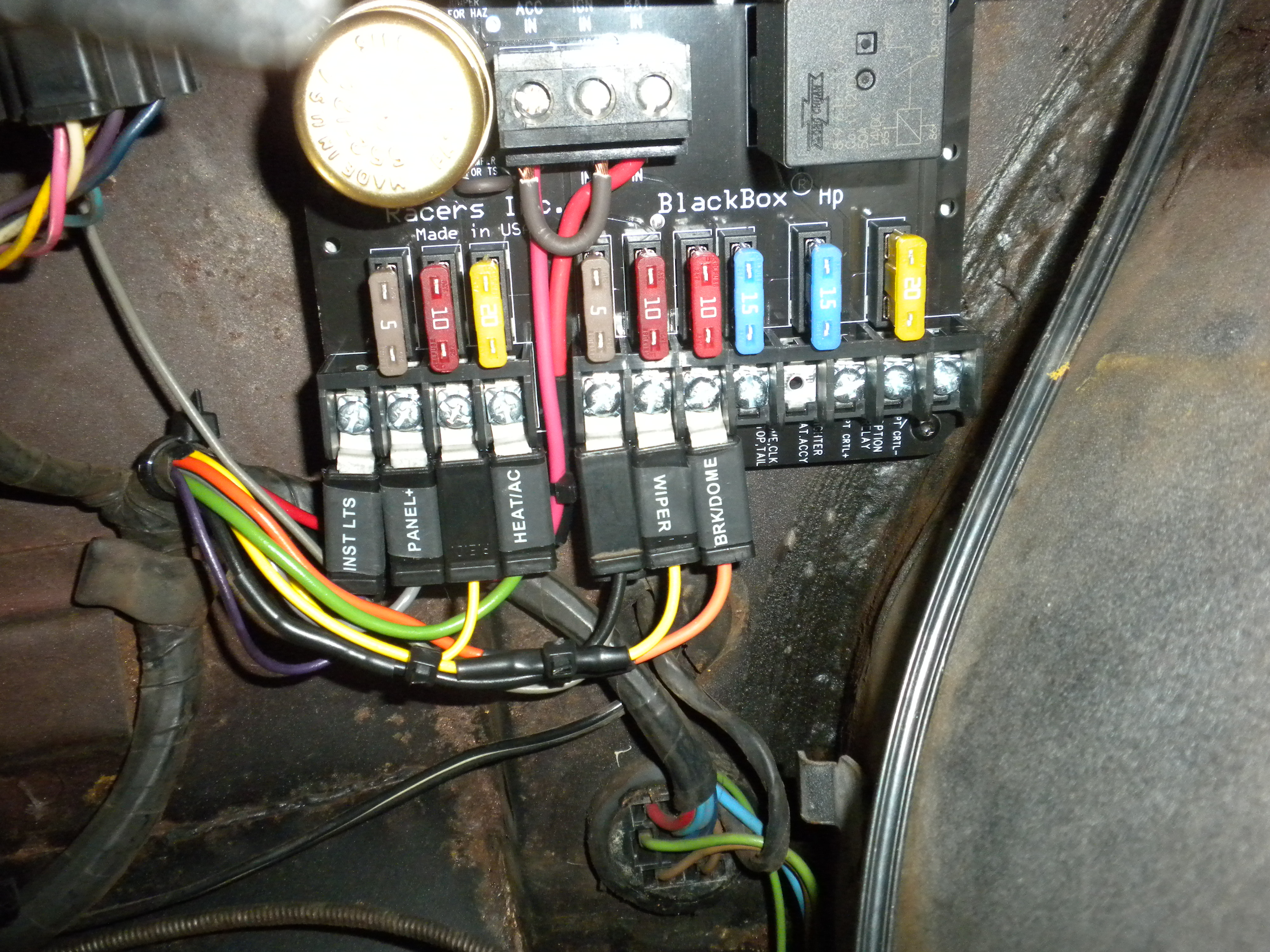

I manufacture fuse panels for the street rod market and I build a special model just for Corvairs. It's called the BlackBox Hp. FWIW, I've been into Corvairs for over 50 years.
I have kits for 60-64 car, 61-65 FC, 65-6 cars, and 67-9 cars.
Here's what the kit looks like in my '66 - This photo is the latest board design.
All parts are included in the kit and there are specific instructions for each Corvair version. If this is of interest, you can read about it here: https://www.racersrods.com/category-s/1825.htm

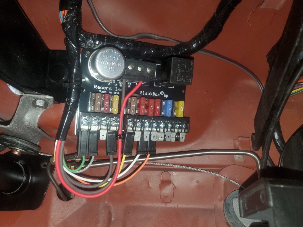

I've got the same upgraded fuse box. Love it.
