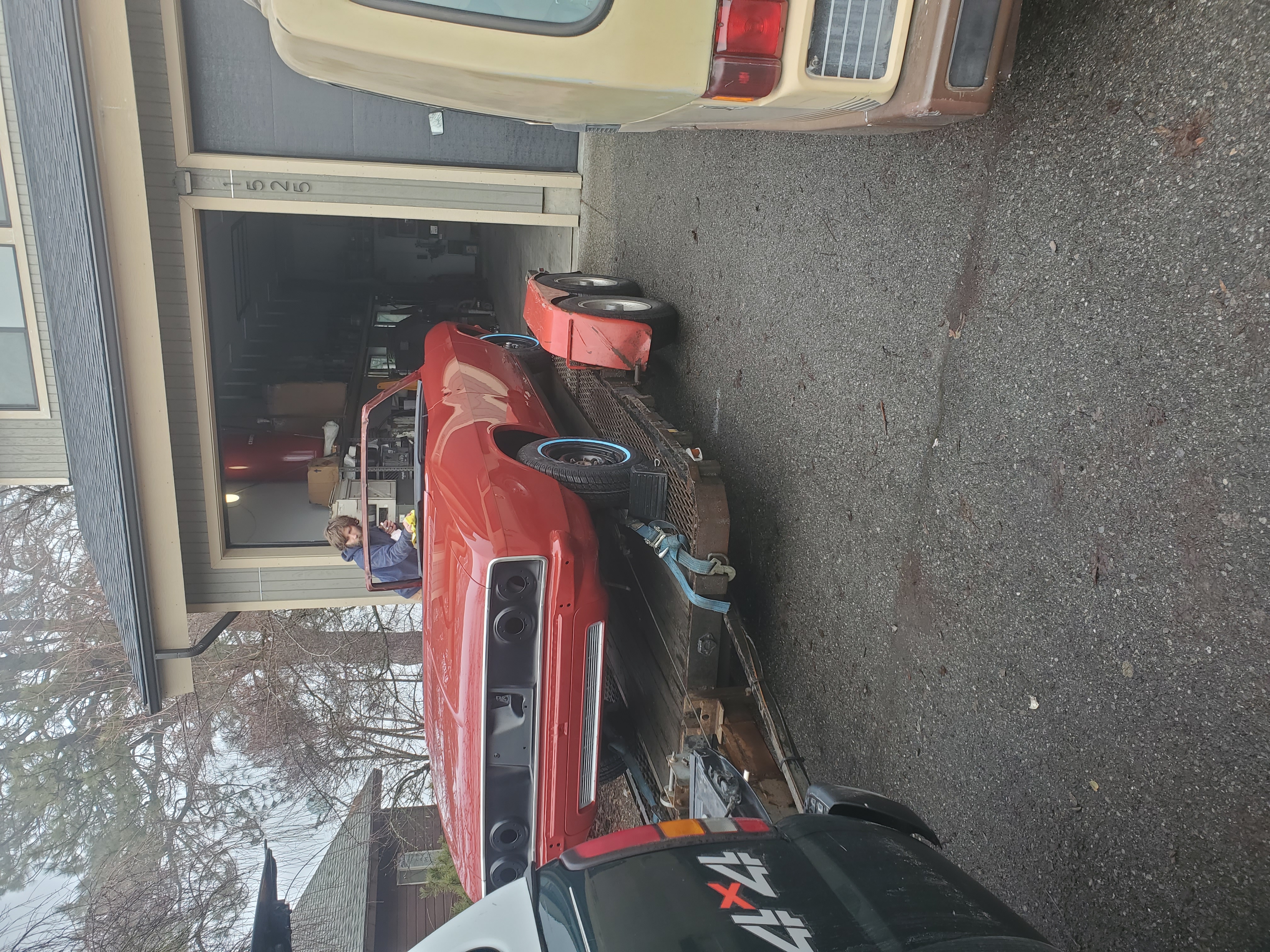

I have the major components ready to go (suspension, engine) but I'm restoring other parts as I go.
The first projects are to load the tunnel, trunk, and front light areas.

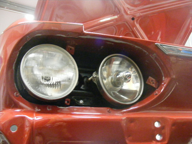

I've done a lot in the trunk: Restore and install directional lights, headlight buckets, headlights, harness, dampers, fill plate. It all takes time but the result is satisfying.

Oddly, the headlight problem was a defective brand-new Wagner headlight!
