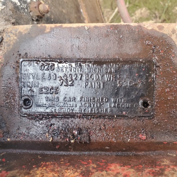

I think I'm beginning to understand what you are looking for. Are you considering this 1963 Corvair "find" to be a car you might want to restore? Are you looking for advice to determine if this would be a good "project car" for you to tackle? Experienced members of the Corvair Forum can certainly "load you up" with advice and opinion, but helping you to determine whether or not to take on such a project means not only knowing a lot of details about the car you are looking at, but knowing something about you, your mechanical skills, knowledge and background. Your location, available garage space, budget expectations (financial and time) is important too!

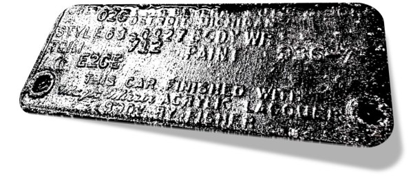

To begin, I will decode the body tag you provided...
BODY TAG INFO:
02C
Body Build Date: 02 = February (1963), C = Third Week
The first digits are numbers 1 through 12, indicating the month of manufacture. The letter is A-E, indicate the week of the month. If the letter is a "C" it indicates the third week of the month.
STYLE 63 0927 BODY WR ????
63 = 1963
Model 0927 — 2-Door Monza Club Coupe — 4 Passenger, 09 = 900 Series Monza, 27 = 2-Door Club Coupe,
WR = Willow Run, Michigan Production Plant, Production Sequence No: UNREADABLE
1963 Monza 2-Door Coupe — 4 Passenger, Total Production: 117,917
HISTORY: A Bomber an Hour
Ford's Willow Run B24 Liberator Factory
circa 1942 BC (Before Corvair)
circa 1959 — Corvair Production at Willow Run Begins
TRIM 712
712 = BLACK (Monza with Bucket Seats)
This 3 digit codes represents the interior paint and upholstery color and seat type.
BODY PAINT 936-7
936 = WHITE "Ermine White"
Lucite No. 4024L, Rinshed-Mason No. A1199, Ditzler No. DDL 8259
Interior: The 1962-63 Corvairs have an extra digit on the trim or paint section of the tag. WRN has the extra digit for interior paint on the Paint section. In this example, 936-7 = White with Black interior paint.
Interior paint codes: (Interior paint codes do not appear on Los Angeles built cars)
1963: 2= Blue 3= Aqua 4= Fawn 5= Red 7= Black 8= Saddle R = White/Red.

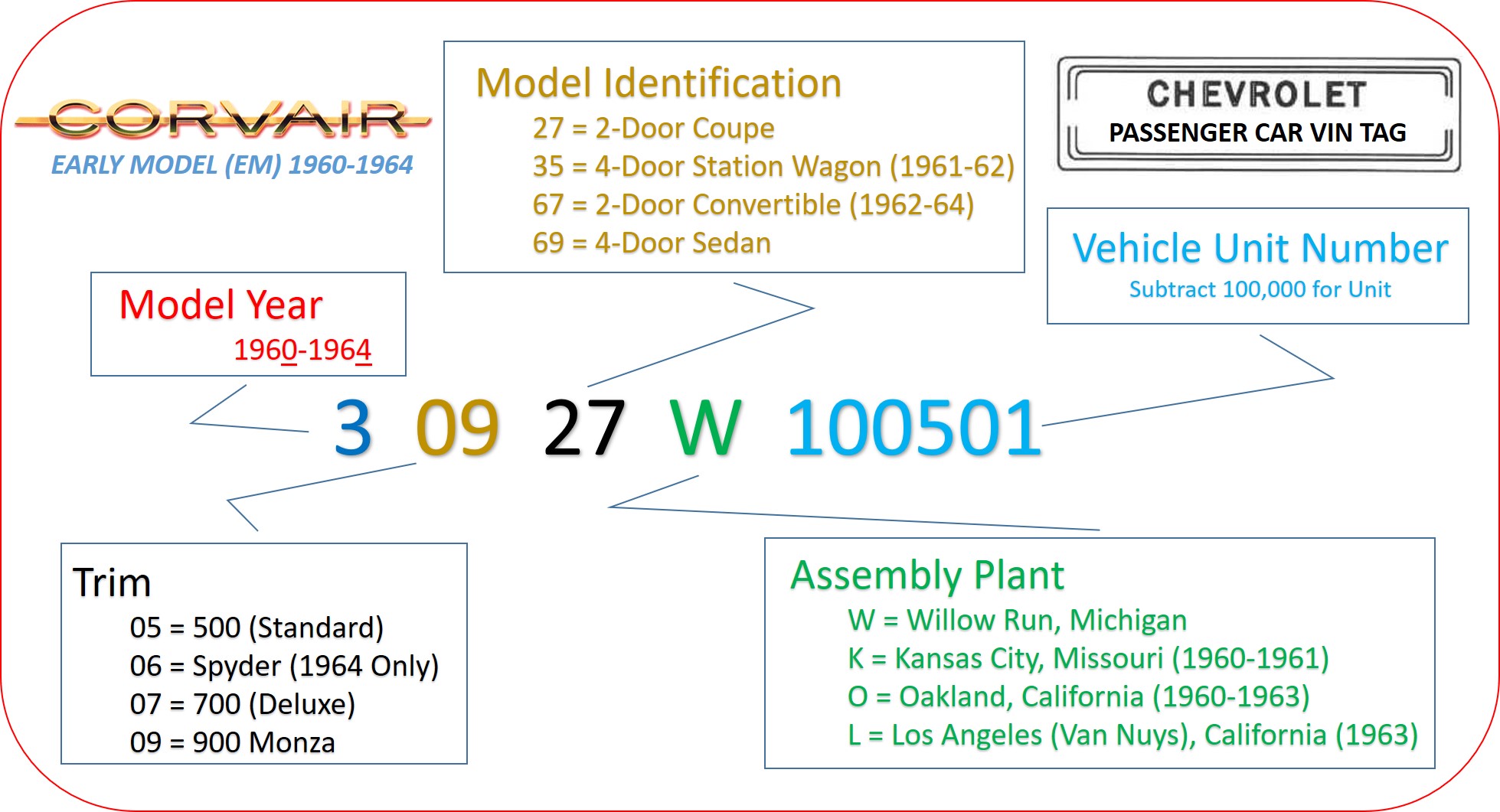

The VIN tag is located in the left door jamb.
