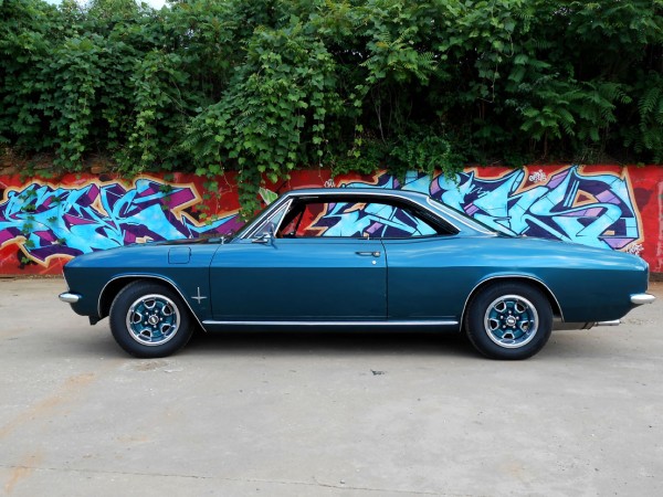

This is what I decided to go with:

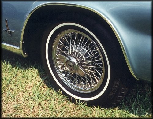

Considering the small number of properly sized 13" street tires now available on the market, and the huge number of choices in 14", 15", 16", or 17" high-quality, high performance tires and wheels that can be fitted to Corvairs, I think the only reason to stay with a 13" tire size would be either owning a show/concours-quality Corvair where seeking show-quality perfection while remaining all-original becomes your objective, or owning a set of unique 13" Kelsey-Hayes wire wheels or a set of Corvair-classic Hands aluminum wheels where 13" makes having those wheels on your Carvair an absolute necessity!

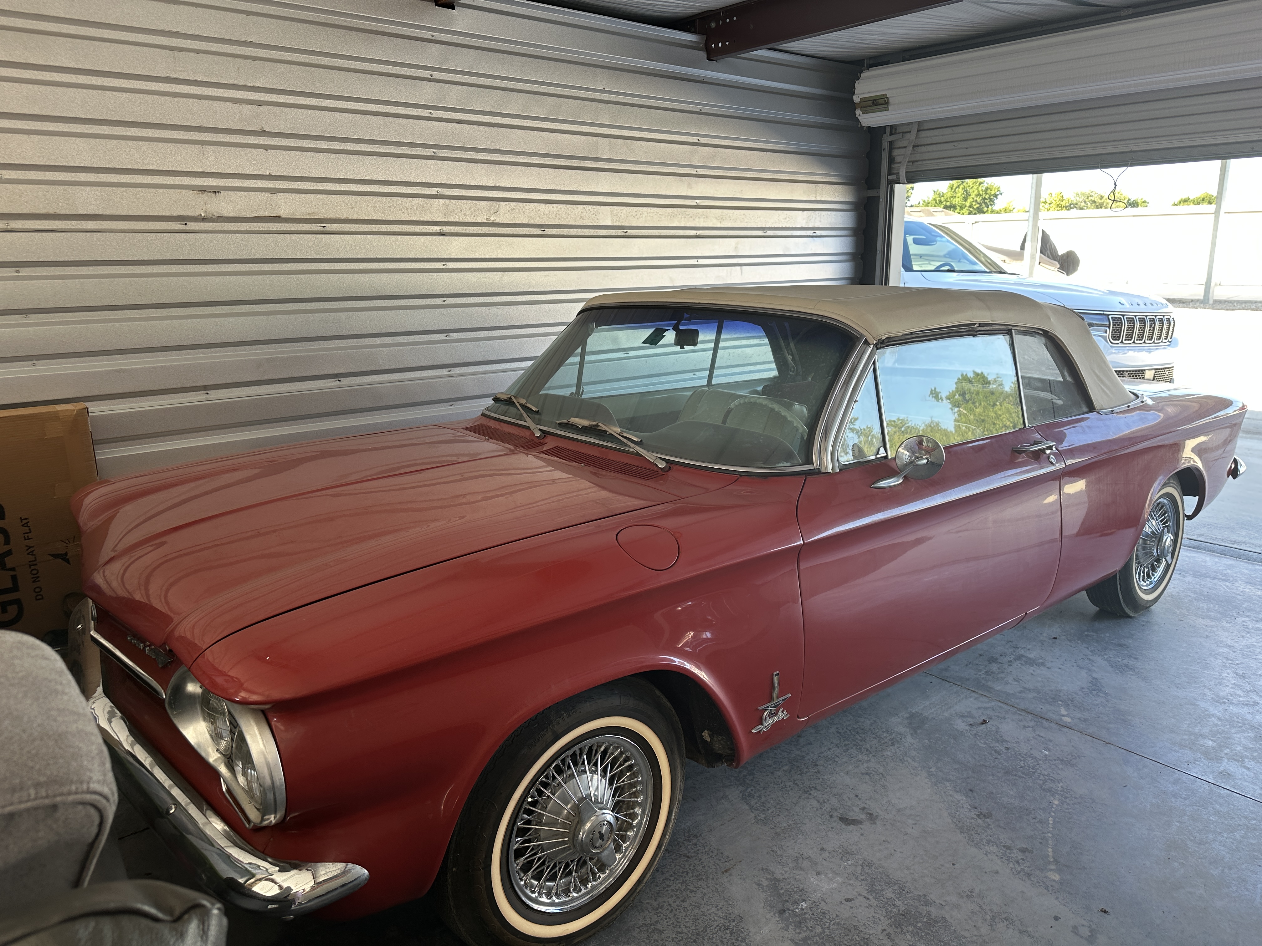

I’ve got these on my ‘63 and I’ve got 4 more that are even nicer. What wheels do you recommend? I’m hoping to get it
running again soon.

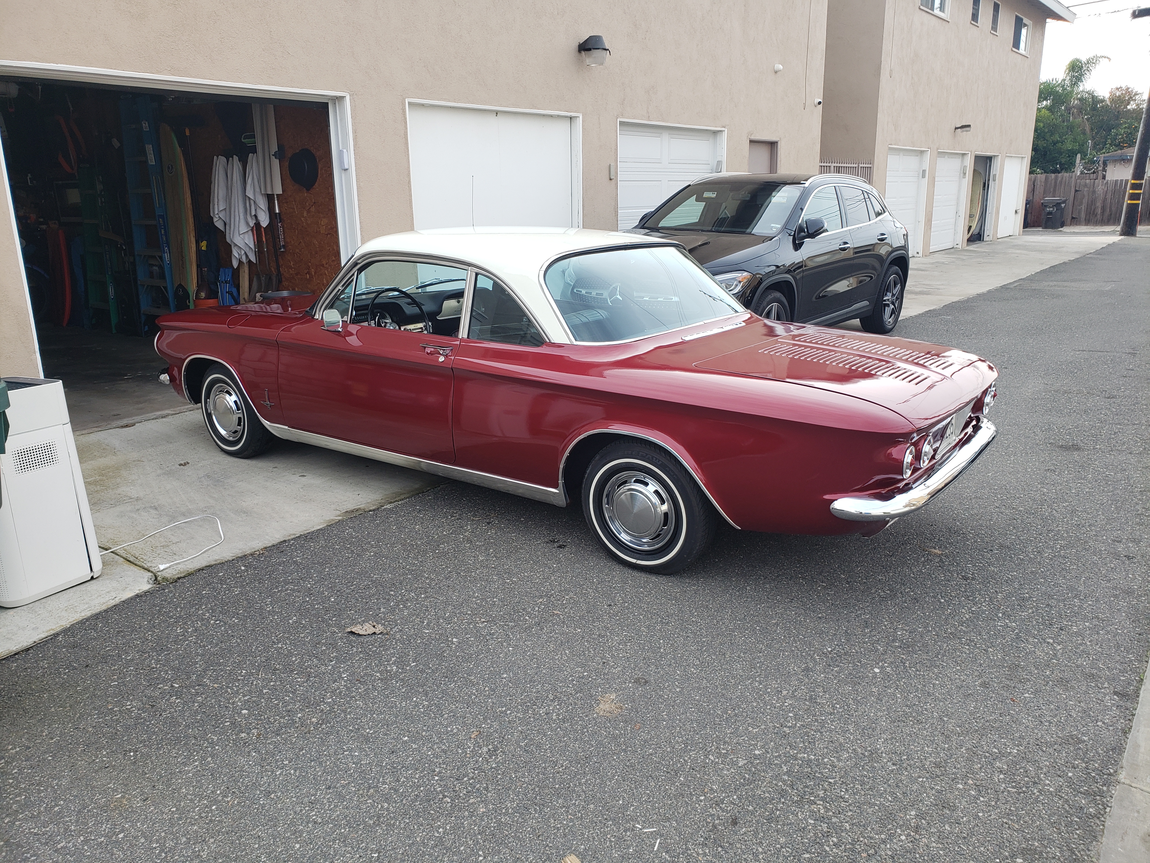

My 64 110hp 4 speed coupe. Before and after new wheels and tires. Original whe nI purchased the vehicle had 13"x5.5" rims with 155/80/13 tires, yes 155 I said not a misprint. It was like riding on Bicycle tires. Just changed them out last week to the 14"x6" poader coated with trim rings and baby moons all the way around, with 205/60/14 on all four with no modifications, and no rub. A little room to spare. Replaced some control arm bushings in front and had a 4 wheel alignment performed. After 2 days shimming and heating bolts to make adjustments they got her pretty well aligned. The ride is much smoother and handling like a little sports car. Looking to perform the same on my 65 500. I believe I will have more options, thanks to all you good folks that take the time to share your pics and information.
