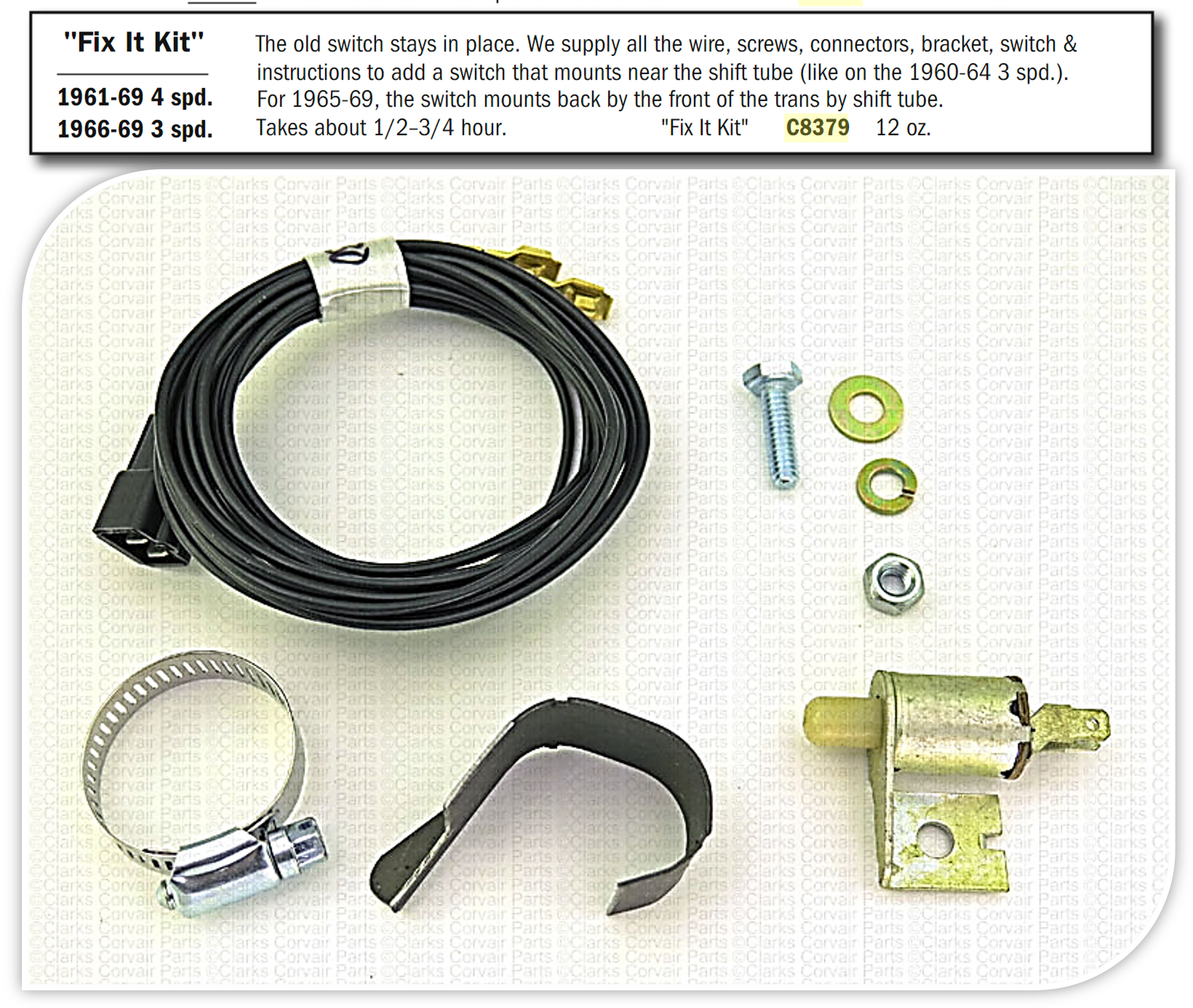

Here is a link to the switch with adapter Clark's sold at one time --- https://ssl.corvair.com/user-cgi/search ... arch=c9805
FiberFab also sold the switch, but they are out of business now. Unfortunately nobody know what modern switch was used and who made the adapter.

Try unscrewing it a little bit at a time to see if the switch opens and the lights go out. If that solves the problem, put a few large washers on the switch to stop it from going in too far.
