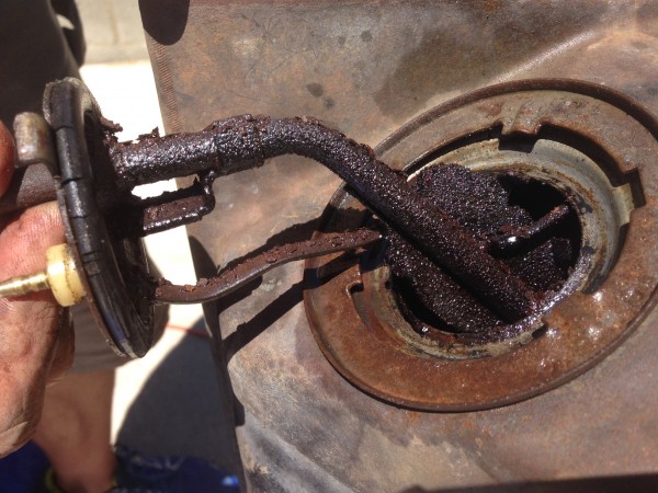

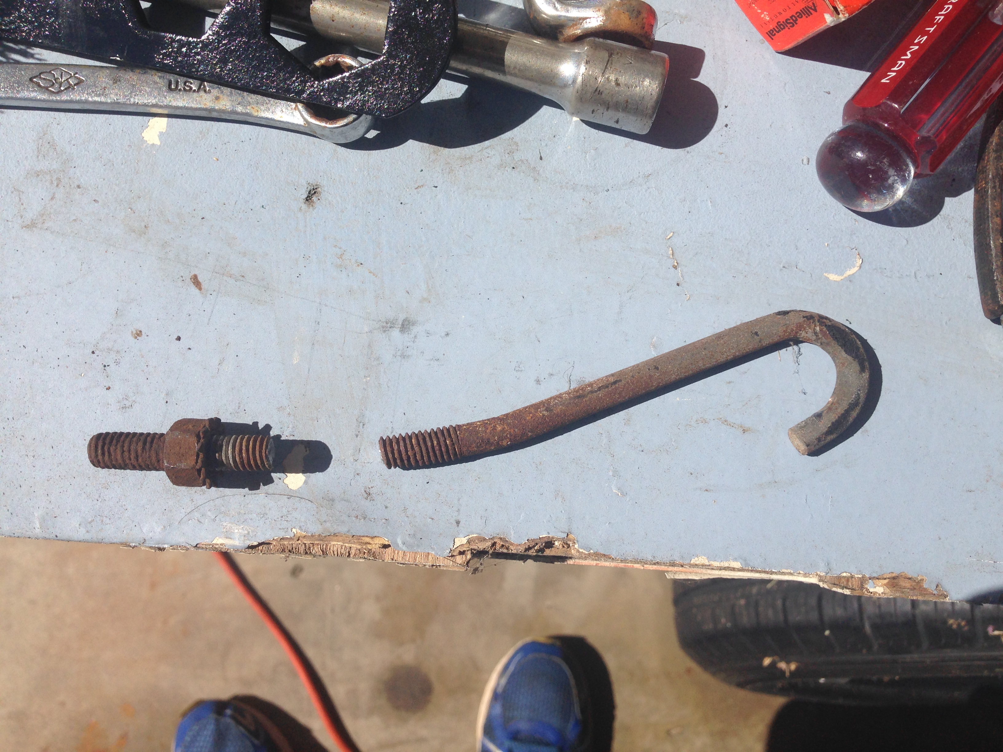

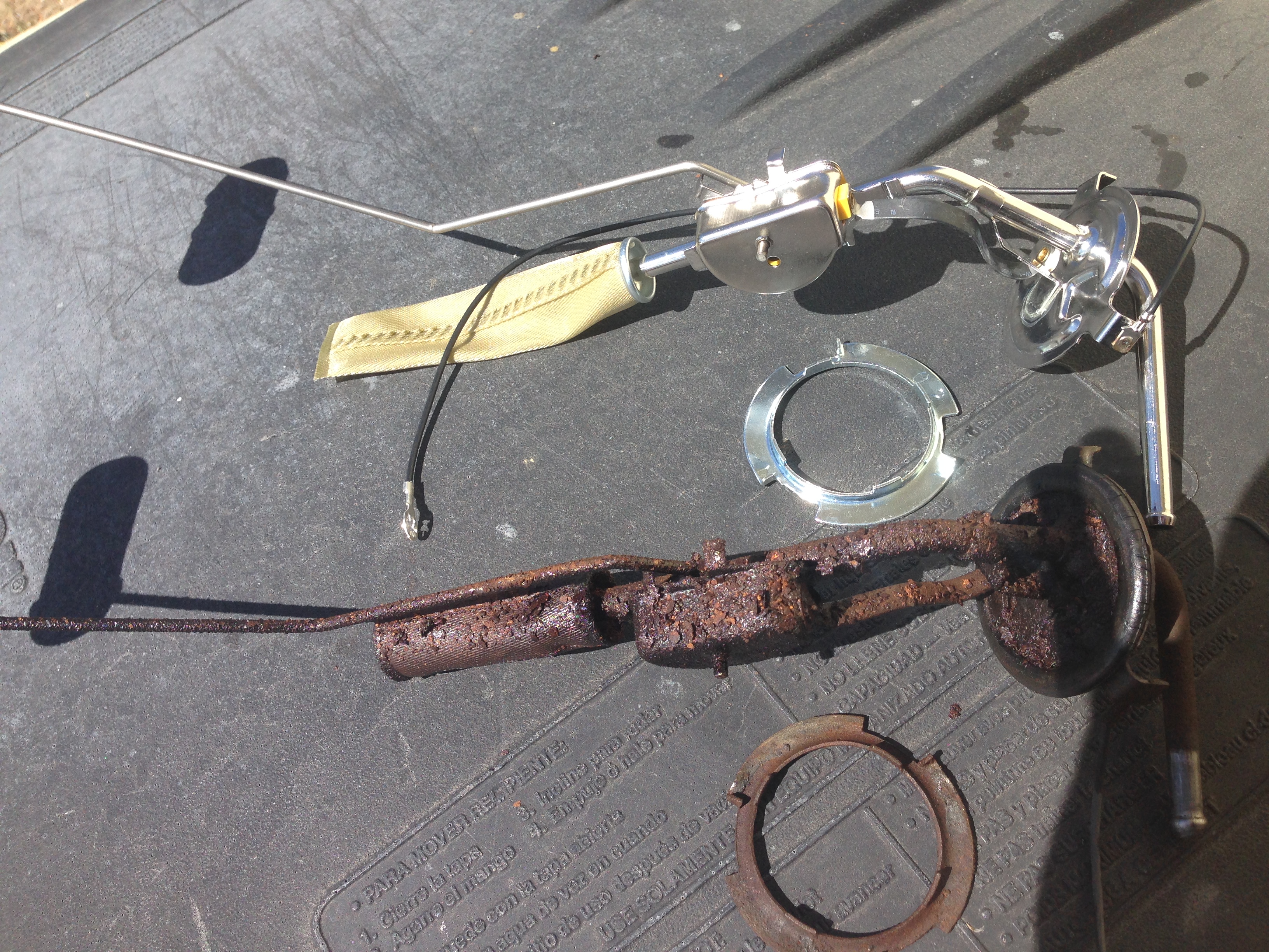

OK, there's some serious rust in there! Tank is solid otherwise. Gonna chain/shake/rinse/repeat and let sit with some Evapo Rust in various orientations before Red Koting.
Tank still had exactly 5 gallons inside, could not remove, outlet was clogged. Added 30 lbs to tank weight, was a bear to wrestle that out. I cut the 1/2" fuel line vent hose. Amazingly, the large ORIGINAL rubber filler hose neck is in perfect shape, still pliable and looks new. Somebody here said their new one rotted in 5 years... maybe rubber was better back then.
NOW WHAT DO I DO WITH A 5-GALLON BUCKET OF OLD GAS?
My old/new tank floats are in opposite orientations... does it matter? Looks like my new one matches Clark's photo.
And my luck changed today, I did break a tank J bolt. :(
