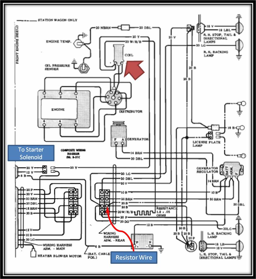

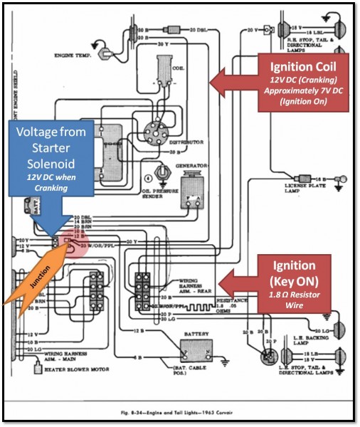

Cranking the engine provides voltage to the coil positive terminal from the starter solenoid as long as the starter is engaged. The moment the engine starts and you release the key, the starter solenoid power source to the coil is discontinued, leaving only the primary ignition wire from the ignition switch, via the main wiring harness and engine compartment multi-connector, and through the ballast wire to provide a nominal 7 VDC to the coil positive terminal. If this primary ignition circuit has a fault, voltage may only reach the coil while the engine is being cranked. Power could be disappearing with the key only in the ON position.
Left-click the image to enlarge it for better viewing or "Pan & Scan". Click a second time for maximum enlargement..
These two diagrams show the difference between 1962 and 1963 wiring. They are electrically the same, but in 1962 two separate wires were routed to the coil, and they joined together at the coil positive terminal. In 1963 the two power sources were joined at the small connector near the starter solenoid — leaving only single wire to be routed the rest of the way to the coil.

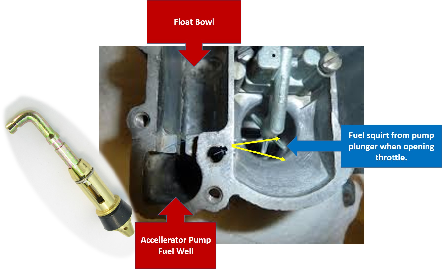

For a quick check on fuel availability in the carburetors, you can peer down the throat of each carburetor while holding the choke open. Open the throttle quickly. You should see a squirt of fuel injected into the carburetor throat from the accelerator pump. This confirms the presence of fuel in each float bowl.There are two relatively simple tests outlined in the Corvair shop manual. These tests measure output pressure and fuel delivery volume. The output pressure test utilizes a common vacuum/pressure gauge that is relatively inexpensive. The output pressure is regulated by an internal spring that is contained in the upper pump housing. Unless your pump springs a leak in one of the diaphragms or seals, it is likely that the output pressure will not change with age. However, new pumps may be fitted with a spring that produces an output pressure well in excess of the 4-5 psi standard. High-pressure can cause carburetor flooding, and is particularly a problem with the Carter YH carburetor found on turbocharged Corvairs, which is sensitive to excessive fuel pressure.

With the air cleaner assembly removed, when holding the choke open and peering down the throat of each carburetor, do you see a squirt of fuel from the accelerator pump in each carburetor when you open the throttle rapidly? If the jet of fuel is not observed, the float bowls may be dry, possibly due to stuck needle and seat assemblies blocking the fuel inlet.
