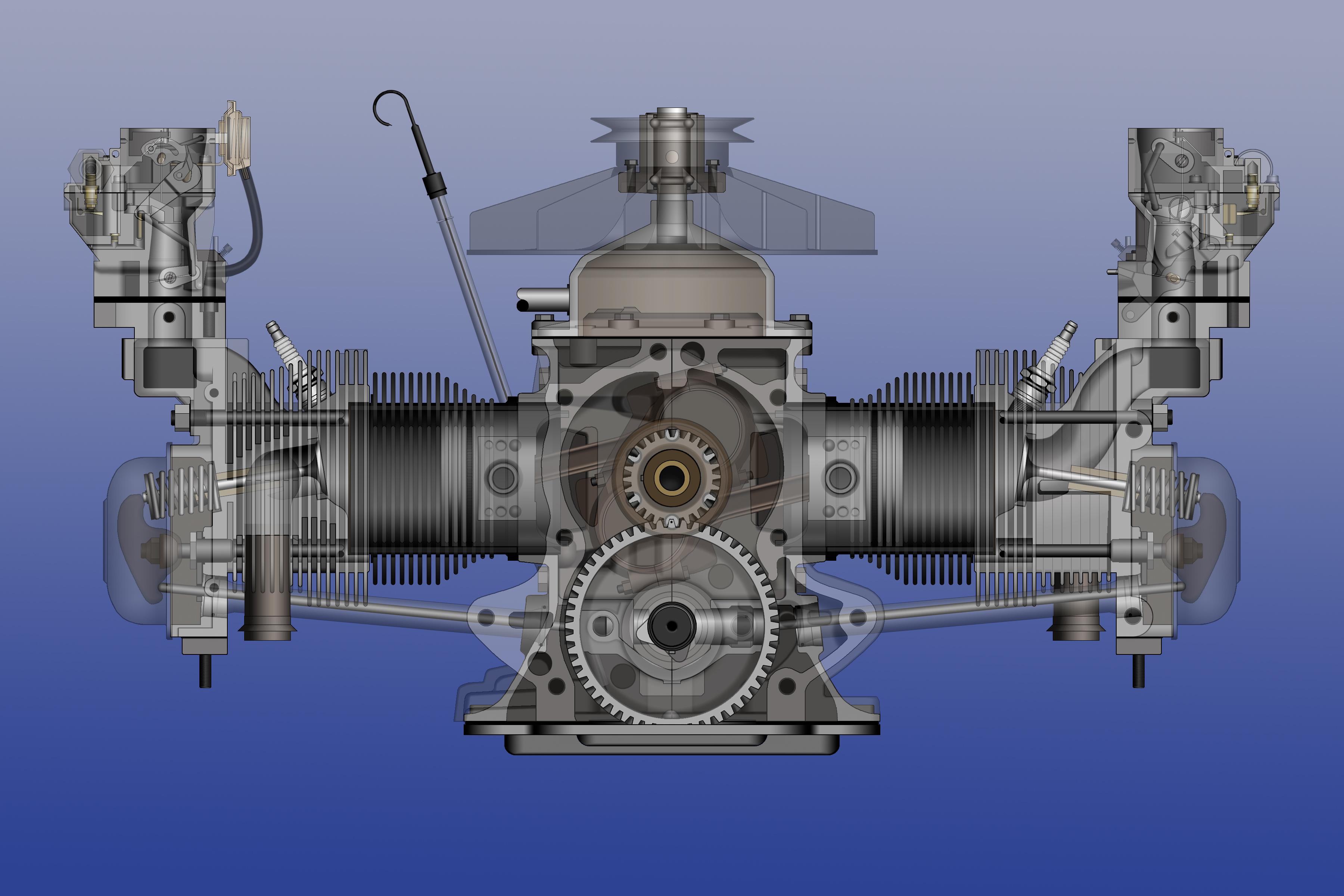

WOW! You can even see the dipstick inside the dipstick tube,
and if you look closely you can see the bottom of the dipstick projecting into the oil pan area!![]()
If you enlarge the view of the Visible Corvair Engine drawing, you can see the timing mark dot on the aluminum timing gear. The Woodruff Key position on the camshaft gear is even correct!
Left-click with mouse to enlarge for better viewing. Click a second time for maximum enlargement...

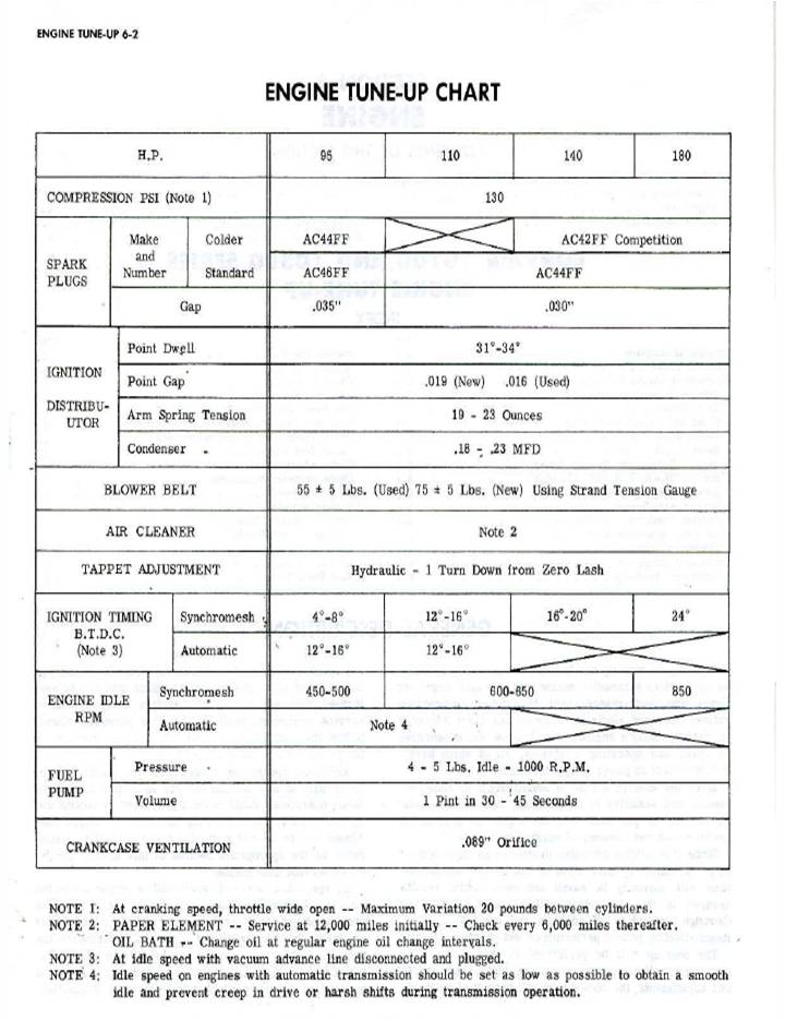

The tune-up chart you asked about was in the 1965 Corvair Chassis Shop Manual - SECTION 6 - ENGINE, on page 6-2 (attached).

See Brad, THOSE pages, with the timing set, ARE familiar. Those links you put up are exactly what's in my 3-rings and what I use for everything I've done. I ain't dumb enough to touch the engine and trans in a car I've never worked on before without detailed instructions. In fact, you should see the state of my "Small Block Chevy Engine Overhaul" book and my "GM Hydromatic Rebuild" book. No matter how many times I've done those the book still comes out every time. I just missed that specification page. I spent a long time lookin' yesterday too
To your point about the schematics, I wound up making my own taking the only good chunks from all of the above
Your instinct was spot on about the valves too. Lets just say some folks have different definition of "no rocker movement" and mine was wrong round 1. Round 2 I followed your video from an old post... that's when my compression came back. "No rocking horse movement" was a much better way to word that
Oh well, from that spec page I now feel really good about my 130psi compression, which hurts my brain even more.
So now..
1. I know my compression is spot on.
2. I know the intake valve is opening during the intake stroke, both are closed the entire travel of the compression stroke, and the eaust valve opens just as the piston starts ascending for the exhaust stroke
3. I know my spark is timed to fire 8 degrees before top dead center on cylinder 1
4. I know my firing order is set per the shroud in a clockwise rotation from #1 position
5. I know my point gap, for my brand new points, is 0.019"
6. My spark tester shines bright on all six cylinders
7. I'm fairly confident in my valve lash
8. I know the fuel pump is delivering fuel to the carbs and filling the bowls
9. I know my accelator pumps are jetting fuel down the carbs when pumped
10. I do not have any pouring gas to indicate the floats are not seating the needle valves
But all of that brings me back to the big question: WHY THE HELL WON'T IT START??? OR EVEN COUGH???
Even with starting fluid and a gas cup she just laughs at me.
What am I missing from the must-have-to-run checklist?
