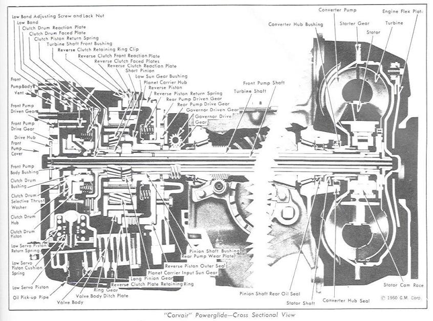

bbodie52 wrote: » Sat Apr 28, 2018 8:22 pm
There are other possibilities, according to the troubleshooting chart on page 45 of 46 in the attached Corvair Powerglide Automatic Transmission Service Guide (broken into 5 parts to permit uploading to the Corvair Forum).
OIL FORCED OUT OF FILLER TUBE...
  • Oil level too high causing planet carrier to run in oil and cause foam.
  • Oil pickup pipe split or not sealed causing air entrainment.
As shown in the illustrations below, there is an O-ring seal [42] in the valve body that provides a seal for the oil pickup [43]. A screw [47] is used to secure the oil pickup. If the oil pickup is loose, or if the O-ring seal has deteriorated, or if the oil pickup has split, it may be that air is being introduced into the oil flow as the oil is drawn into the system by the pump. This could be a possible cause of foaming in the oil.
The following Clark's Corvair Parts Tech page discusses several issues with Powerglide transmission in Corvairs, including the proper length of the transmission fluid dipstick...
:link: http://www.corvair.com/user-cgi/catalog ... ge=TECH-16
The transmission vent is shown below, in the upper-left side of the image...
Photos complements of davemotohead
