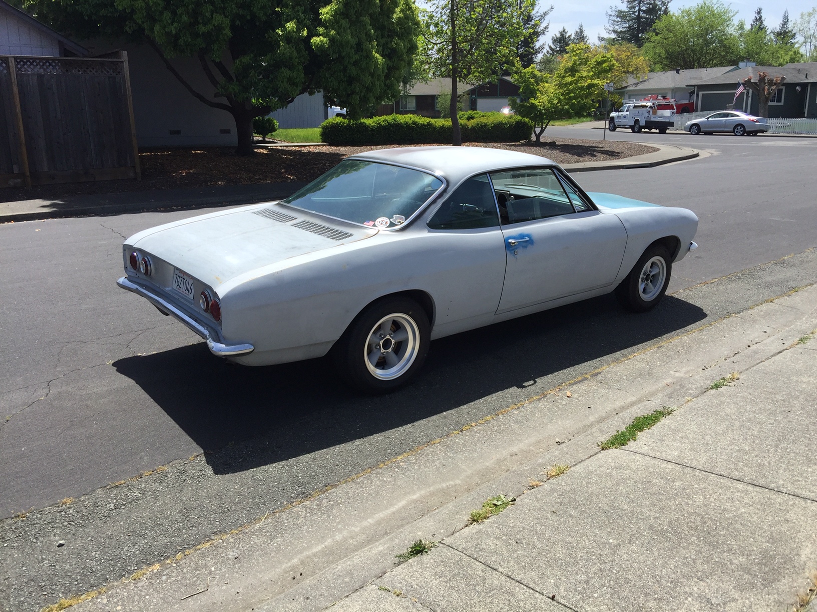

Solved- Locking Up Right Rear Brake and new rear Wheels
Hi Corvair Bad Asses :)
I have resolved my right year tire braking lock-up! The one that caused a lot of blue-white tire smoke at times, and alarming tire screeching.
My 17 year old son and I completely disassembled that drum brake and installed a different new set of brake shoes. And two new springs. Of which the the hefty top one is really important, like they all are :). For whatever reasons I used the old one even though I bought new spring sets. The old one seemed weaker, and pinged when dropped on the garage floor. The shoes had some strange wear spots and might have been defective. Some mechanics told me that so much junk parts are sold now. We went for a short tooling-around wearing the new classic AR Torque Thrust rims and 216 60 15 rear rubber. Slamming the brakes. What a great feeling! We high-fived!! We did it. I really dislike working on drum brakes and got through a personal psychological barrier, I think. At least temporarily...
I was really wanting the classic Torque Thrust wheels out back, in silver, sans weird caps. Impulse shopping. Aggressive look.
Thanks for all your help on this completely annoying and dangerous issue. I used all of your ideas to check stuff.
