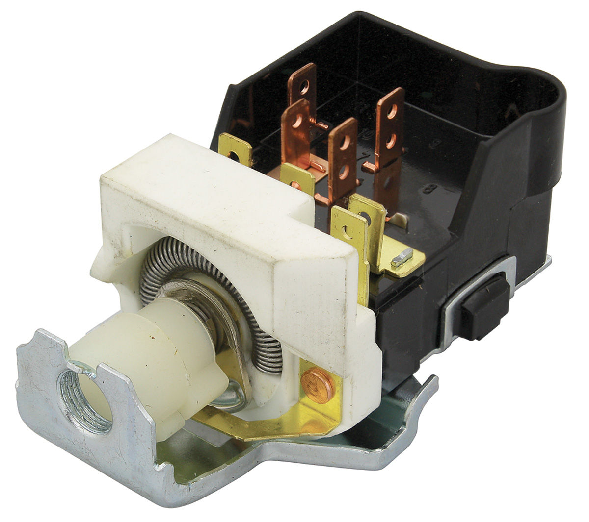

I'm not sure about disassembling the light switch. If no voltage is coming from the terminal connected to the 20 DG wire, the fault could be an internal contact or the rheostat (dimmer) portion of the switch. The switch is probably more than 50 years old and a replacement is less than $20. You might just opt to replace the likely faulty/worn switch assembly.
http://www.corvair.com/user-cgi/catalog ... N&page=84B
Part number C1332: 64-69 HEADLIGHT SWITCH
Weight: 0 lbs 10 oz
Catalog Pages(s): 84B,R-24
Price: $ 16.95
BACKGROUND INFO...
All of the instrument panel lights are fed by a single wiring harness distribution point behind the instrument panel. The wire color code is 20 GY (20 Gauge Gray). One possible fault location could be inside the 12-pin multi-connector behind the instrument panel. Even if the two plastic halves of the connector shell are tightly seated, a bent or corroded metal pin inside could be a disruption point.

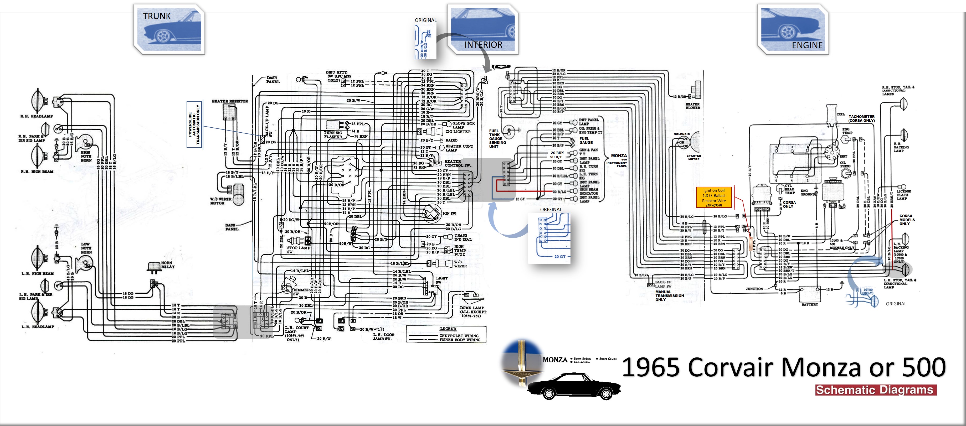

The Corvair shop manuals divide the engine compartment, interior, and trunk wiring diagrams into separate sections that are displayed on separate pages. Sometimes it is easier to analyze a circuit if you can trace it end-to-end on the same page. The schematic is displayed below as an embedded image that can be enlarged by left-clicking it with your mouse for better viewing. If the cursor appears with a plus (+), the image can be clicked again to further enlarge it...
Left-click the image to enlarge it for better viewing or "Pan & Scan". Click a second time for maximum enlargement...

If the running lights work then the internal contacts are working. All that is left is the rheostat but if you turn them all the way bright it bypasses the resistor. If the wiper is bad that would prevent them from working.

The rheostat in your light switch consists of a fixed wire coil resistor and a moving metal contact, or WIPER, that slides along the coil resistor to tap in at continuously variable points along the coil, which varies the resistance in the circuit to dim or brighten the instrument lights by changing the amount of electrical current flowing.nmunn wrote:...can you expand on the comment “if the wiper is bad that would prevent them from working”? I don’t see a dependency in the schematics on the wiper circuit.

Interesting update. New switch came in and still no interior lights. If I jump power from the red terminal to the green terminal the lights work fine.

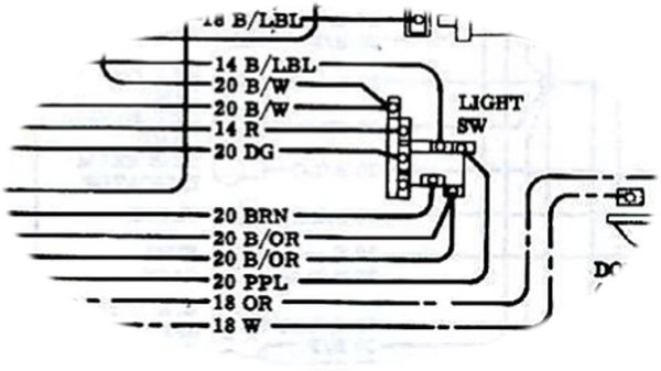

With a multimeter set as an ohmmeter to test for continuity, and the new switch unplugged, you should be able to see a connection between the switch terminal that normally connects to the 14 R wire, and the switch terminal that connects to the instrument lights (20 DG). The circuit switch should be closed when the switch knob is pulled halfway or all the way out (running lights or headlights). If your multimeter shows circuit continuity through the light switch terminals, you should measure different resistance settings (in ohms); as you rotate the dimmer knob. Continuity testing with an ohmmeter between the various switch terminals and the main input (14 R) should confirm all of the various switch settings, depending on the main light switch knob position.
NOTE: I FOUND SOME OF THESE PICTURES ON THE WEB — NOT NECESSARILY CORVAIR BUT GM — SOME CORVAIR COLOR CODES MAY BE DIFFERENT.

Which versions? The smaller images will enlarge for better viewing when you left-click them. A second click will enlarge them to maximum zoom to allow you to scroll around and see the details. All of the images started from the diagrams posted in the 1965 Chevrolet Corvair Chassis Shop Manual. I just did some combining and editing, and some corrections, cropping, etc. for various illustrative purposes. I used Microsoft PowerPoint for the editing changes and for combining three pages into one to create a continuous wiring schematic.
