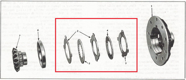

...Fortunately Seth Emerson on the corvaircenter forum just announced he is selling reproduction POSI clutch packs. NOS are scarce and $$$$$$...
FYI: I located the Seth Emerson - Positraction Clutch Plate Pack information that was referred to above. The web-page contains additional comments, but the Positraction Clutch Plate Pack does not yet appear on his referenced website.
:link: http://corvaircenter.com/phorum/read.ph ... 996,991097
Seth Emerson wrote:New Positraction Plate kits available
Posted by: Seth Emerson
Date: August 15, 2018 11:22AM
As shown at the Pittsburgh Convention – Now Available for sale
Brand New Positraction Clutch plate packs for the Corvair differential.
Fits all years 1962-1969
Correct Bellville Washers for preload – All 5 internal pieces included
Slightly higher preload than stock – No need for thicker spacers.
Available now - List price is $125 - Introductory Price $100 + $7 shipping (+ $7.25 sales tax if shipped to a California address.)
24 packs available now, more to come.
Performance Corvair
3462 Kirkwood Dr.
San Jose, CA 95117
Seth Emerson
Check my new Performance Corvair Web site https://www.perfvair.com/
Positraction maintenance information begins on page 4-21 of the attached 1965 Corvair Chassis Shop Manual - SECTION 4 - REAR AXLE.
