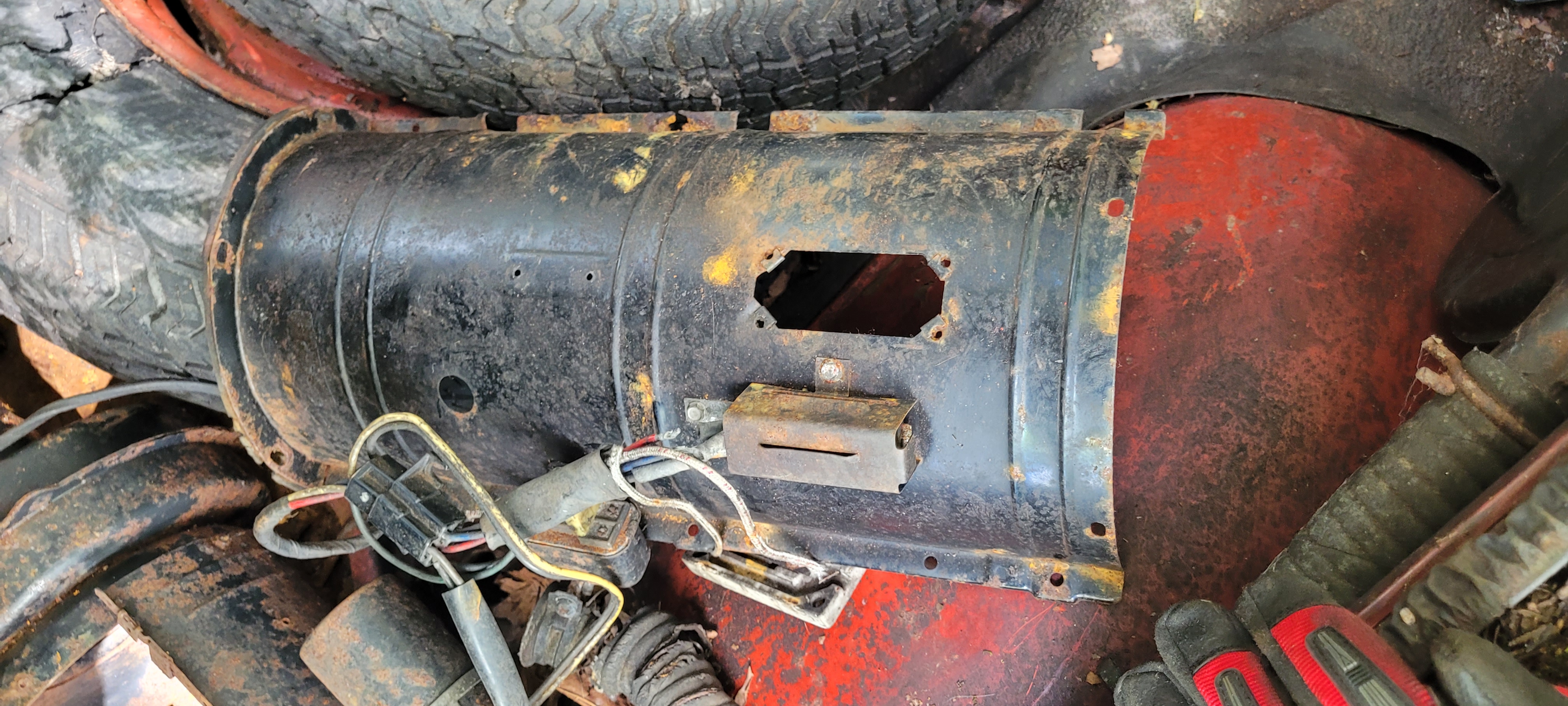

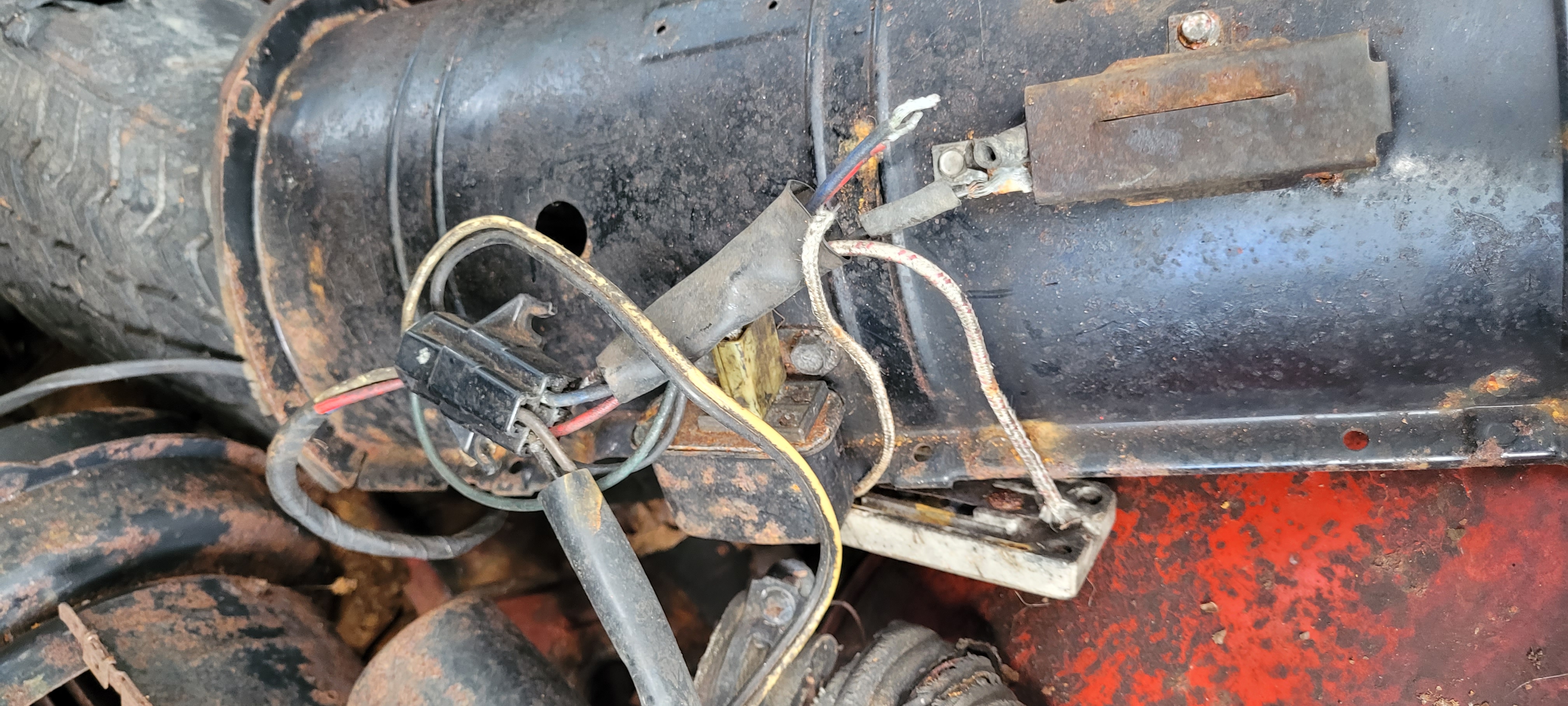

We're can I find a whole brand new gas heater for a 60 model?
I recently looked at the gas heater and see i can't salvage it. I need to buy a whole new one. Parts are missing and I think the blower motor is seized because when I turn it it moves slow. I'm going to Assume the original owner took it apart because I have no screws or bolts to put it back together. What is this rubber thing? It's hard and dry

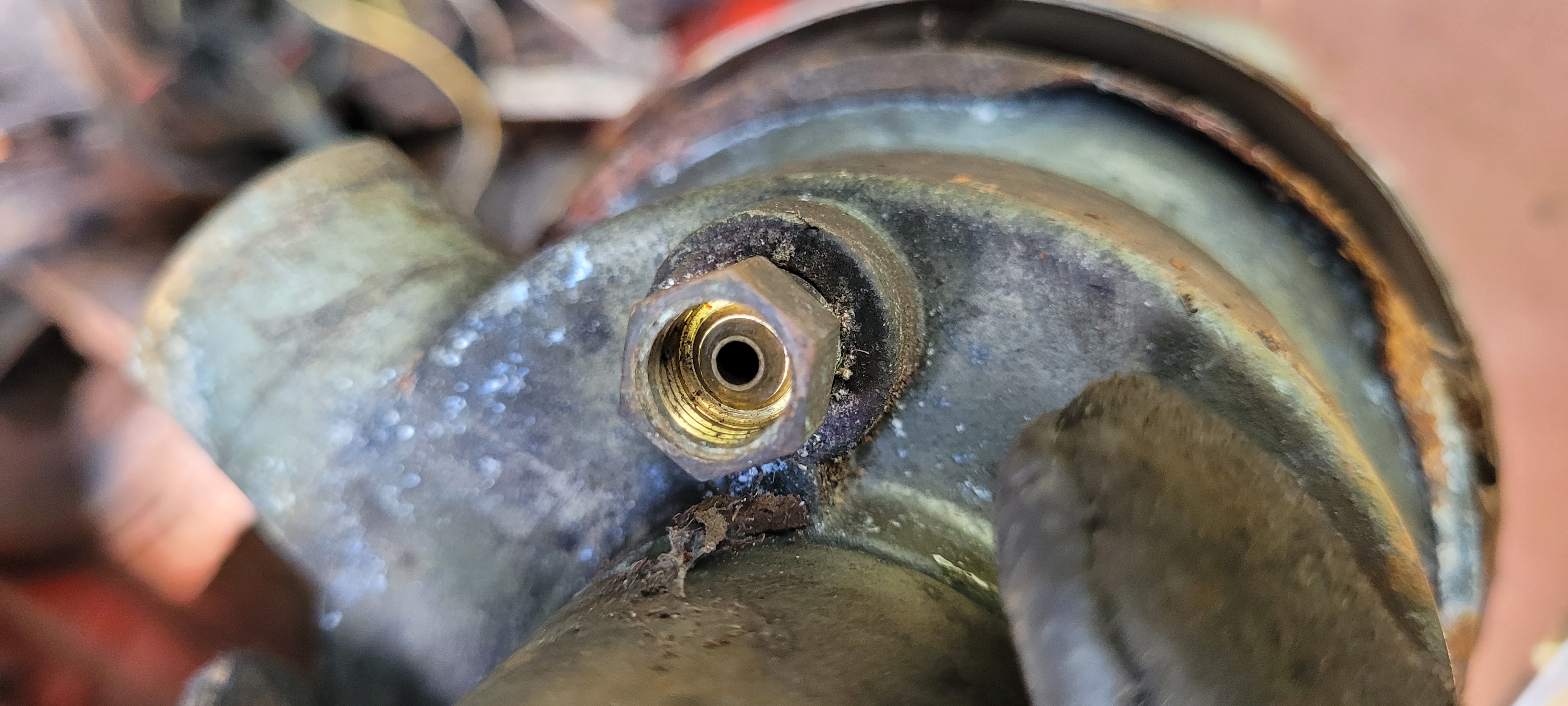

The grommet looks like one for the wiring going into the trunk of a late model. It could also be used on the earlies also.
Re: We're can I find a whole brand new gas heater for a 60 model?
Regarding the ebay unit above...I don't see the exhaust outlet elbow pipe coming out of the unit. If it's not there (broken off) that unit is NOT viable.
Also, the ebay unit is very rusty, I would hold out for one that's not rusty (most are NOT rusty) and any gas heater you but MUST have a perfect and solid exhaust elbow.

Yeah that part isn't in the trunk. I might delete the whole gas heater until I git a new one. At least the car won't be used in the winter time since it will be a car show carcnicol wrote: ↑Sun May 04, 2025 9:14 pm Regarding the ebay unit above...I don't see the exhaust outlet elbow pipe coming out of the unit. If it's not there (broken off) that unit is NOT viable.

Just so you're clear on this, the exhaust elbow that comes out of the heater's heat exchanger is NOT something you would find in the trunk. The exhaust pipe might be in the trunk but the elbow is part of the heat exchanger inside the main heater unit. If the elbow is missing, that means it has rusted off the stainless steel heat exchanger. Replacement heat exchangers are rare and expensive - $350-$400 I would imagine. A missing or loose elbow renders the gas heater unit "junk" except for small parts.Corvair_man wrote: ↑Sun May 04, 2025 10:10 pmYeah that part isn't in the trunk. I might delete the whole gas heater until I git a new one. At least the car won't be used in the winter time since it will be a car show car
