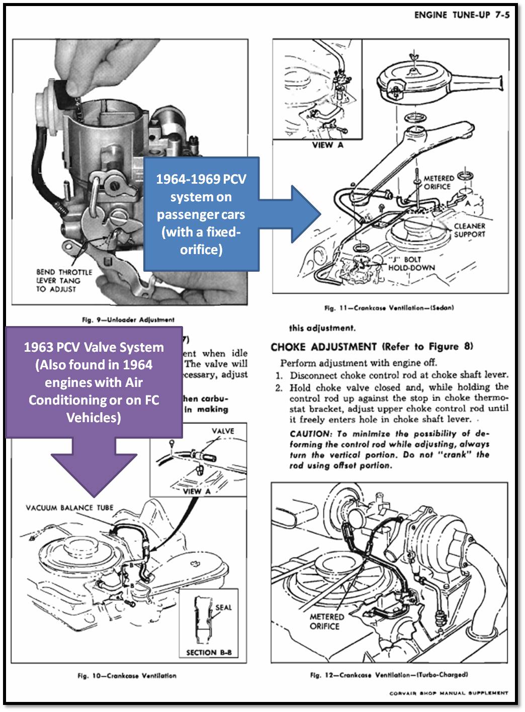

But the factory GM design utilizes a fixed "metered orifice" to provide some measure of control between the crankcase and the main vacuum balance tube. When vacuum levels are low (open throttle conditions) some degree of compensation for the low vacuum is an alternative of filtered air and draw into the carburetor intake. With your setup, it is tied ONLY to the vacuum source which is at its maximum vacuum during closed or partial throttle. When vacuum is low, would this closed system allow crankcase pressure to rise too much? A filter on either the OIL CATCH CAN or via a link tube to a carburetor air filter would give full throttle/high RPM/low intake manifold vacuum conditions a path for crankcase pressures under these conditions to vent via the air filter path alternate similar to the original PCV system. At high engine RPM speeds, crankcase pressure buildup is likely to be at its highest when the vacuum manifold extraction is at its lowest level. The other designed PCV path into the carburetor inlet air filter would seem to be necessary to avoid high crankcase pressure and contamination levels.
As mentioned before, without a metered orifice, would the "controlled vacuum leak" via an unrestricted path from the crankcase into the vacuum balance tube permit too much air to move into the balance tube? How much restriction comes from the OIL CATCH CAN device? Instead of a direct crankcase breather line into the OIL CATCH CAN, should the GM fixed orifice be included in that path to the OIL CATCH CAN device, and should a filtered breather be included also to duplicate the design of the original PCV system?

Yes that is probably some things I need to ad to it.bbodie52 wrote: ↑Thu Aug 26, 2021 11:23 am But the factory GM design utilizes a fixed "metered orifice" to provide some measure of control between the crankcase and the main vacuum balance tube. When vacuum levels are low (open throttle conditions) some degree of compensation for the low vacuum is an alternative of filtered air and draw into the carburetor intake. With your setup, it is tied ONLY to the vacuum source which is at its maximum vacuum during closed or partial throttle. When vacuum is low, would this closed system allow crankcase pressure to rise too much? A filter on either the OIL CATCH CAN or via a link tube to a carburetor air filter would give full throttle/high RPM/low intake manifold vacuum conditions a path for crankcase pressures under these conditions to vent via the air filter path alternate similar to the original PCV system. At high engine RPM speeds, crankcase pressure buildup is likely to be at its highest when the vacuum manifold extraction is at its lowest level. The other designed PCV path into the carburetor inlet air filter would seem to be necessary to avoid high crankcase pressure and contamination levels.
