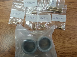

Got my parts just now, looks like I have something to do tonight.
- weberparts.jpg (47.26 KiB) Viewed 1665 times

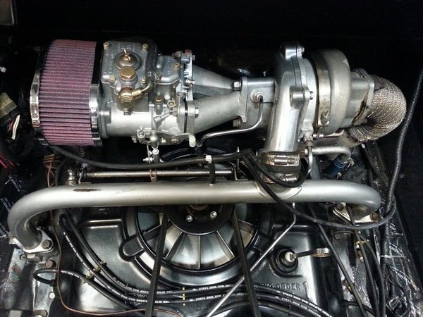

Great info, I'm in the process of doing the same set up, except I have a 180/150 combo. How are you controlling detonation? Was also wondering if you did any machining to the weber adapter. It seems to look on the small side. Post a few more pics of your
Re: Looking for some Weber 40dcoe base line info

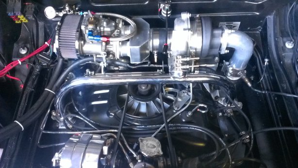

Here's my old setup. I used a weber turbo adapter with a 3" outlet and a rajay e flow compressor and housing which has a 3" inlet. No restrictions there! Detonation is controlled with water/methanol injection in the turbo outlet and a safeguard timing control box. And waste gate of course.
