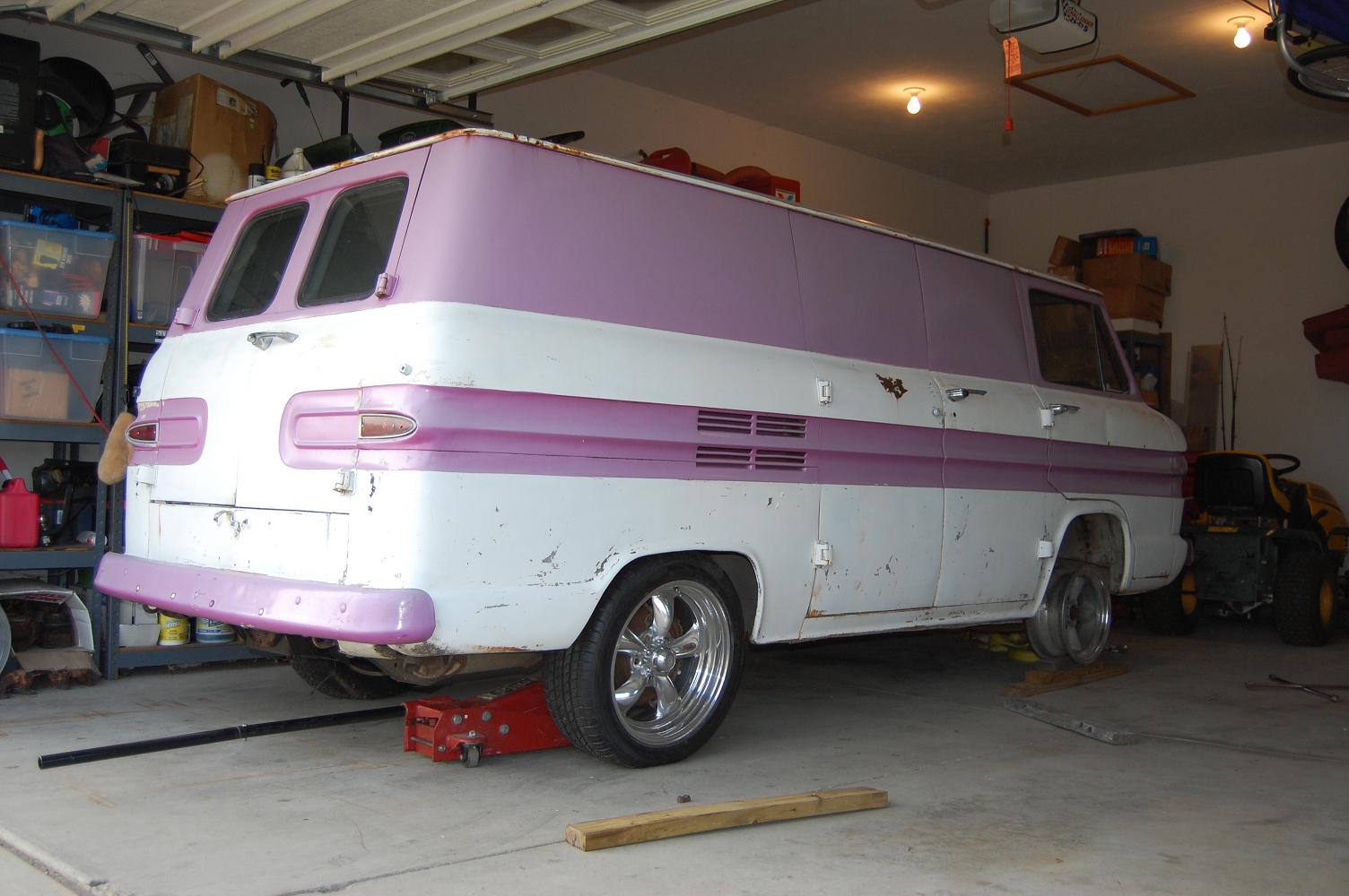

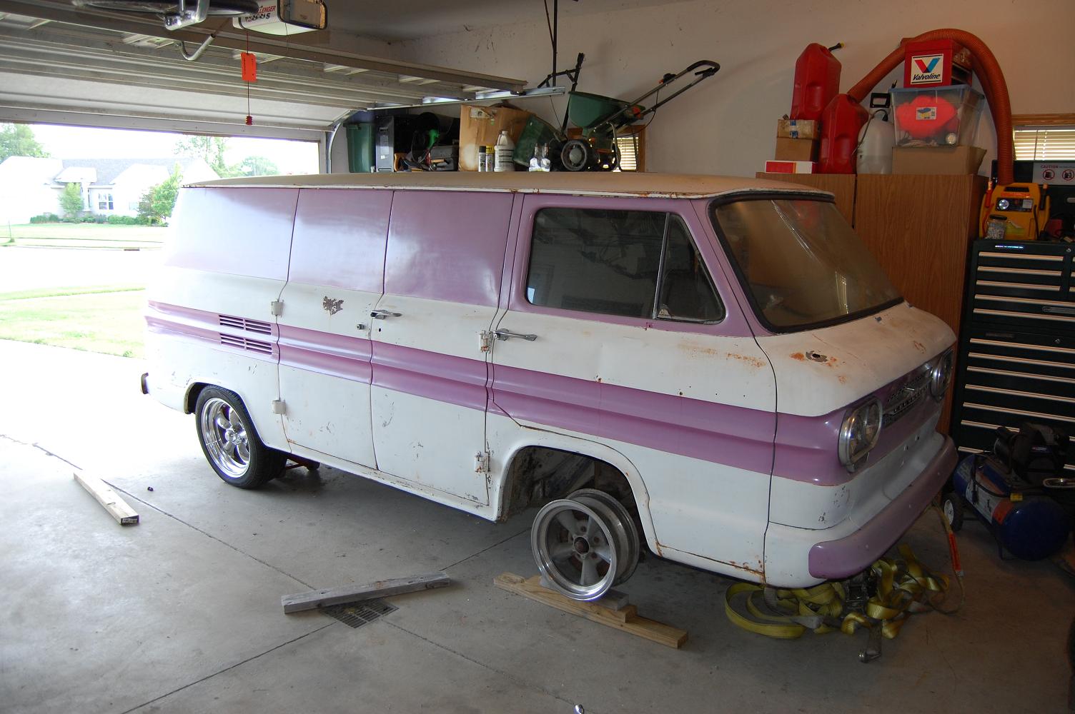

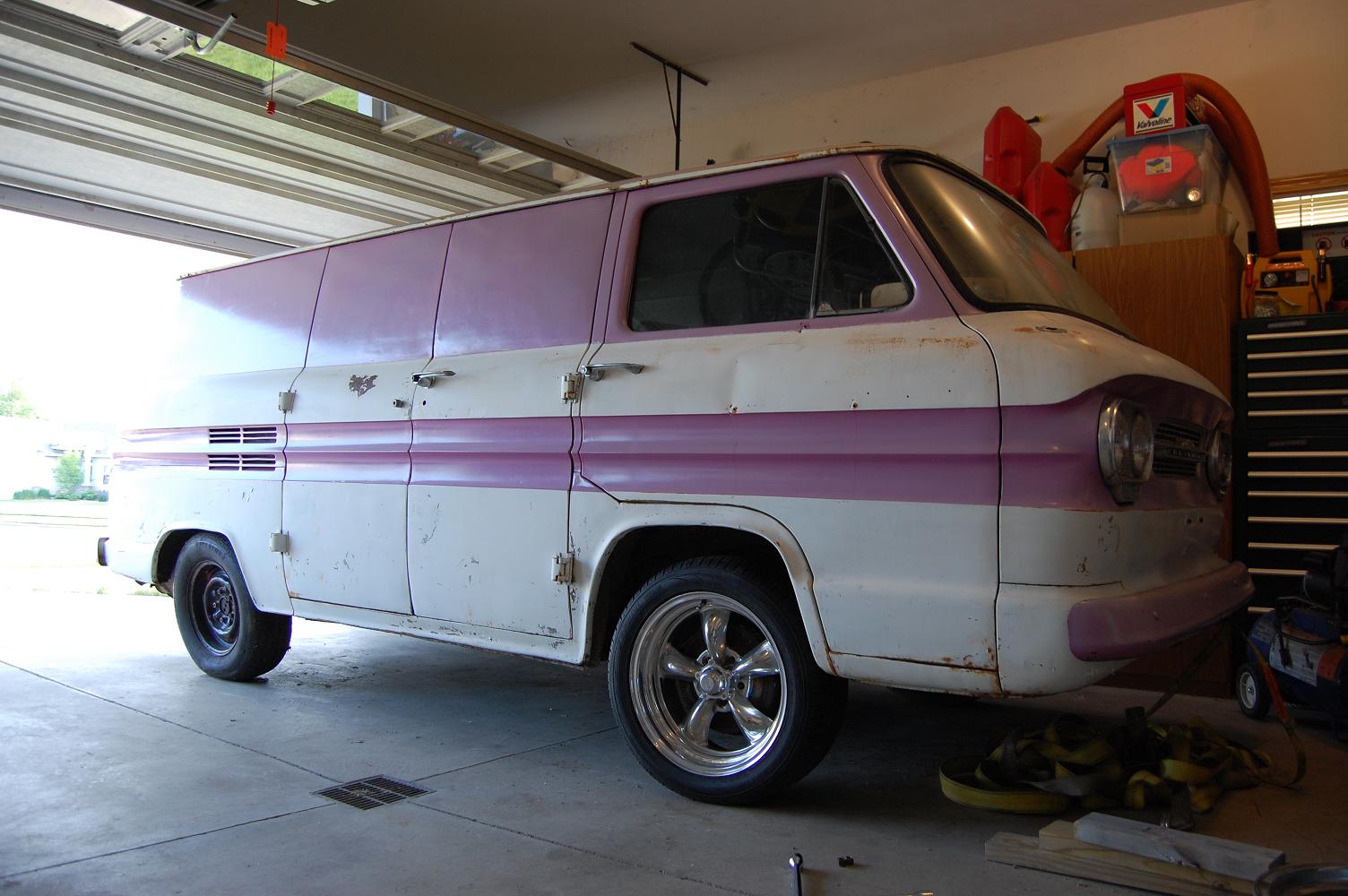

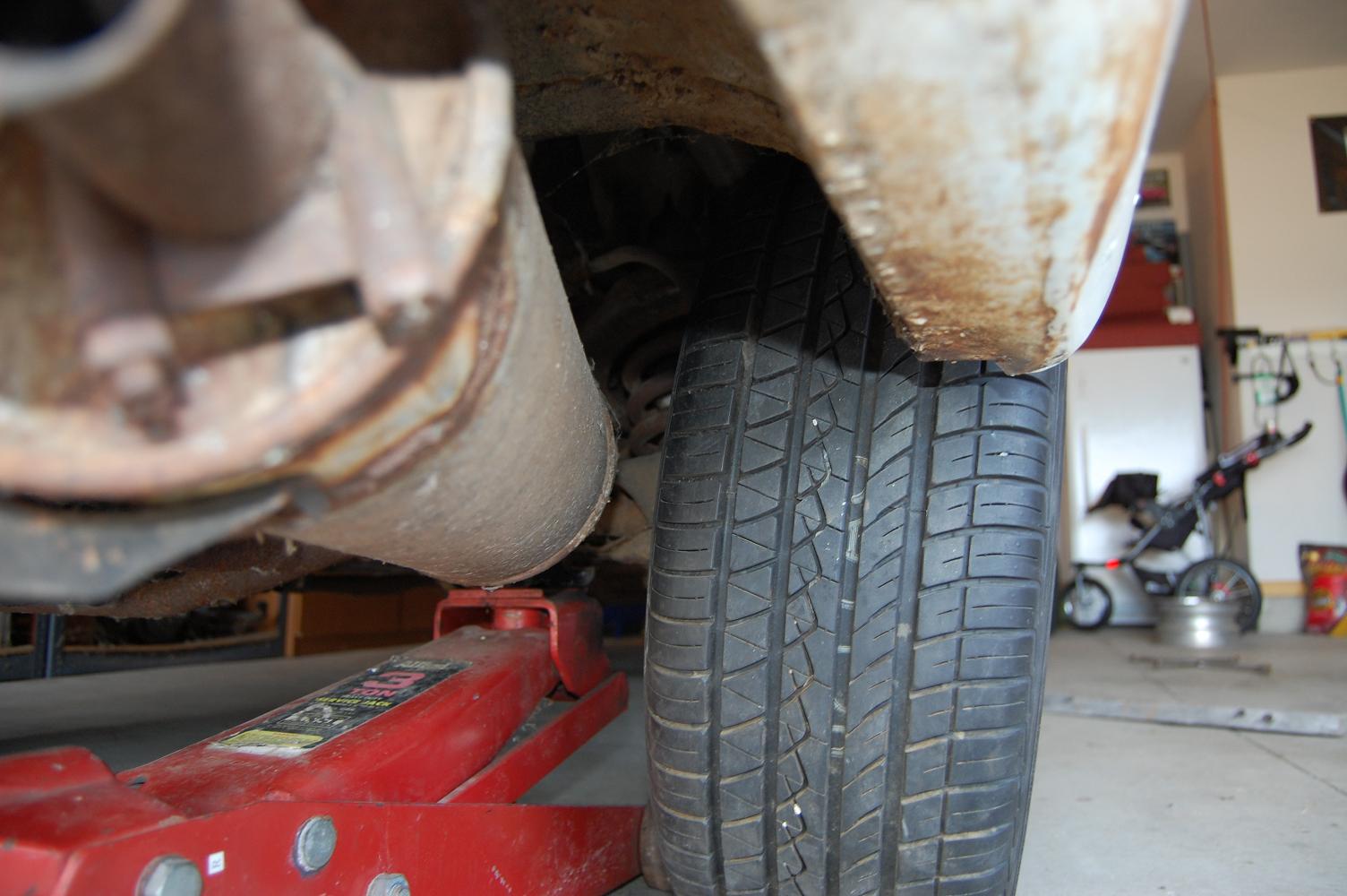

Well, I test fit one of the 17x7 Torque Thrust II's last night and it fit very well front and rear. The backspacing was 4.0". I took pictures on the front and the rear (I just had one rim to test fit), but there was plenty of clearance on the rear, and in the front I was able to turn lock to lock without getting close to rubbing. They also had plenty of clearance at the outer tie rod end.

Here are some pics of the wheels being test fit. It was 90+ degrees so I didn't feel like rolling it back and forth to settle the rear suspension hence the gnarly positive camber.

I'll upload them to this site. Vanman can see you them now?
