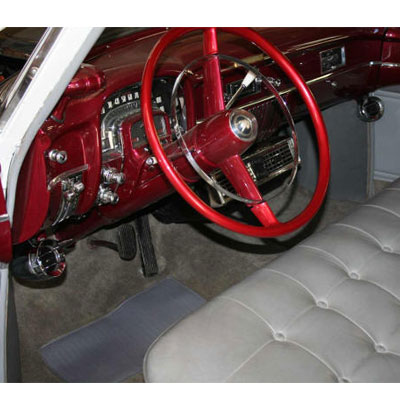

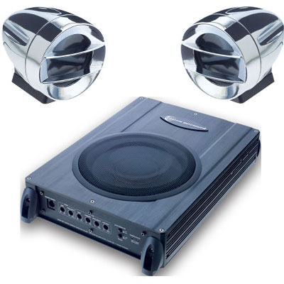

You could run some small hidden speakers under the dash, and then run a subwoofer under the seat. Check out this setup....
http://www.classiccarstereos.com/produc ... tem-1.html

There's a forum post out there somewhere with low profile speakers under the seats in small boxes. Thinking this is what I will do as I don't want to see them at all. I do like the post above with the subwoofer under the seat. I'd like to see those speakers hidden under the dash though.

The CAS speakers are OK, but I am not blown away or anything. I am going to try another receiver and see if that helps
