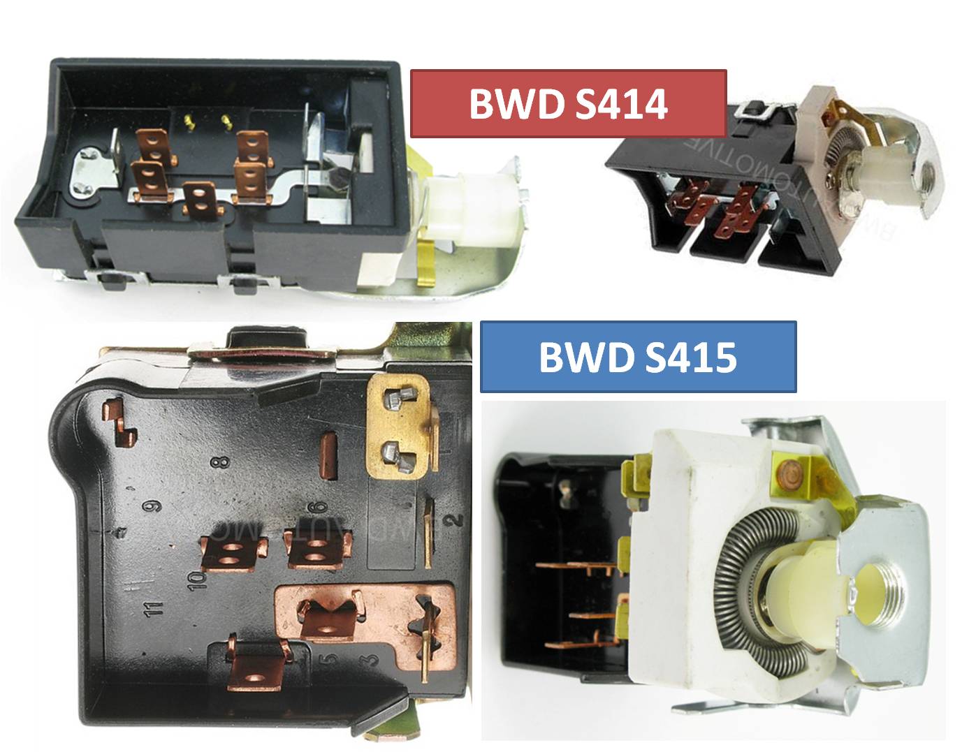

As seen in the pictures at the end of this post, there is a significant difference in the physical layout of the 1960-1963 Corvair switch and the switch used in 1964-1969 Corvairs. There is no way to mix them up. You may simply have a defective switch.

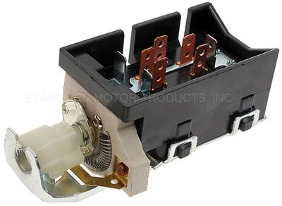

NOTE: The Amazon.com website does indicate that this switch is compatible with the 1963 Corvair and it is in-stock.
The Standard DS156 is also listed on the Summit Racing website for $51.97 The Summit Racing website does indicate it is compatible with 1960-1963 Corvairs.

Here is a physical comparison between the BWD s414 (1960-1963 Corvair) and the BWD s415 (1964-1969 Corvair) switches. The electrical connector physical layout used is completely different.
